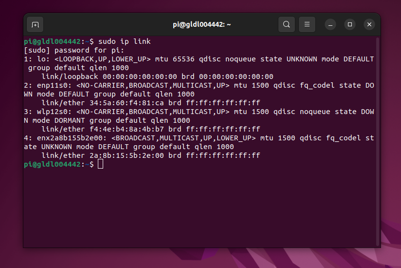

  3. On the Linux host, identify the newly added USB RNDIS network interface name (usually starts with enx), for example enx2a8b155b2e00:
    ip link
  4. On the Linux host, assign an IP address to this interface:
    sudo ip link set enx2a8b155b2e00 up
    sudo ip addr add 192.168.0.6/24 dev enx2a8b155b2e00
    Replace enx2a8b155b2e00 with the actual interface name detected on your host.

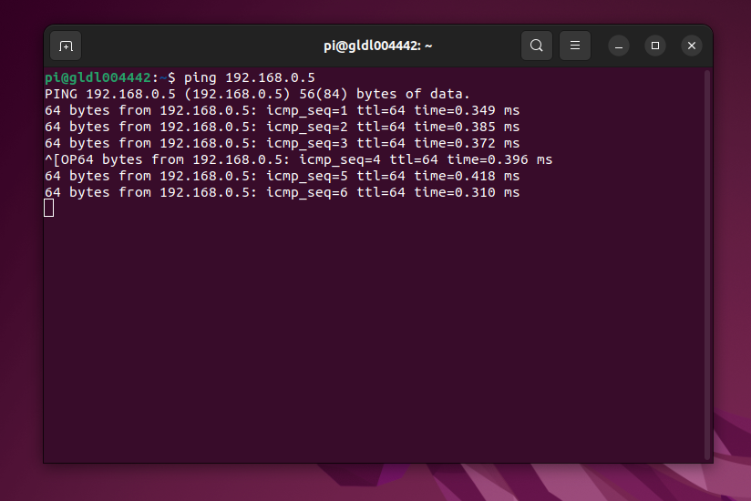

  5. Test connectivity:
    ping 192.168.0.5
    A successful response indicates the RNDIS connection has been established.

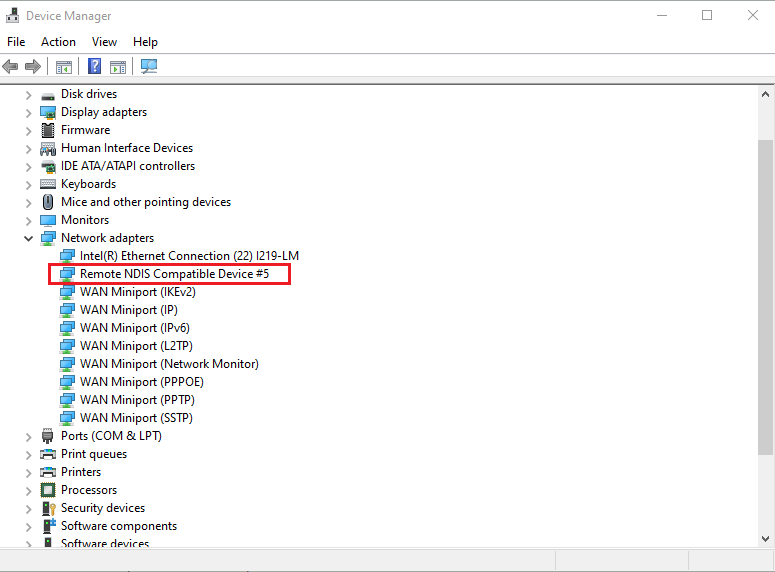

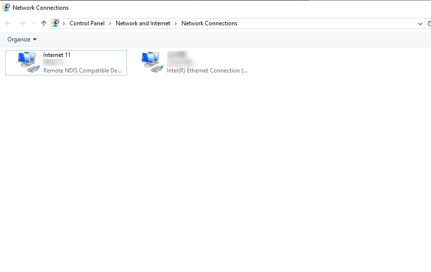

  1. On Windows, identify the newly added USB RNDIS adapter.

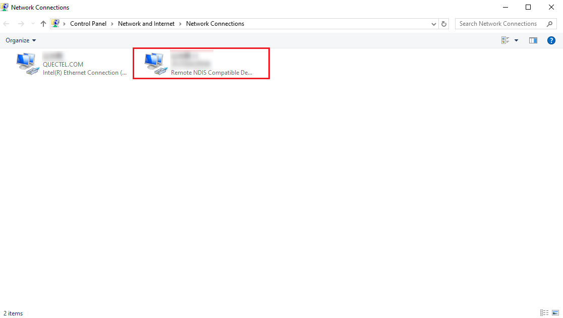

In Device Manager, you will see Remote NDIS Compatible Device under Network adapters. A new Ethernet connection will appear in Network Connections.

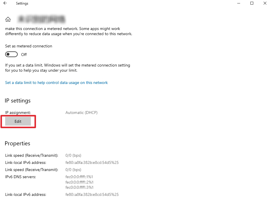

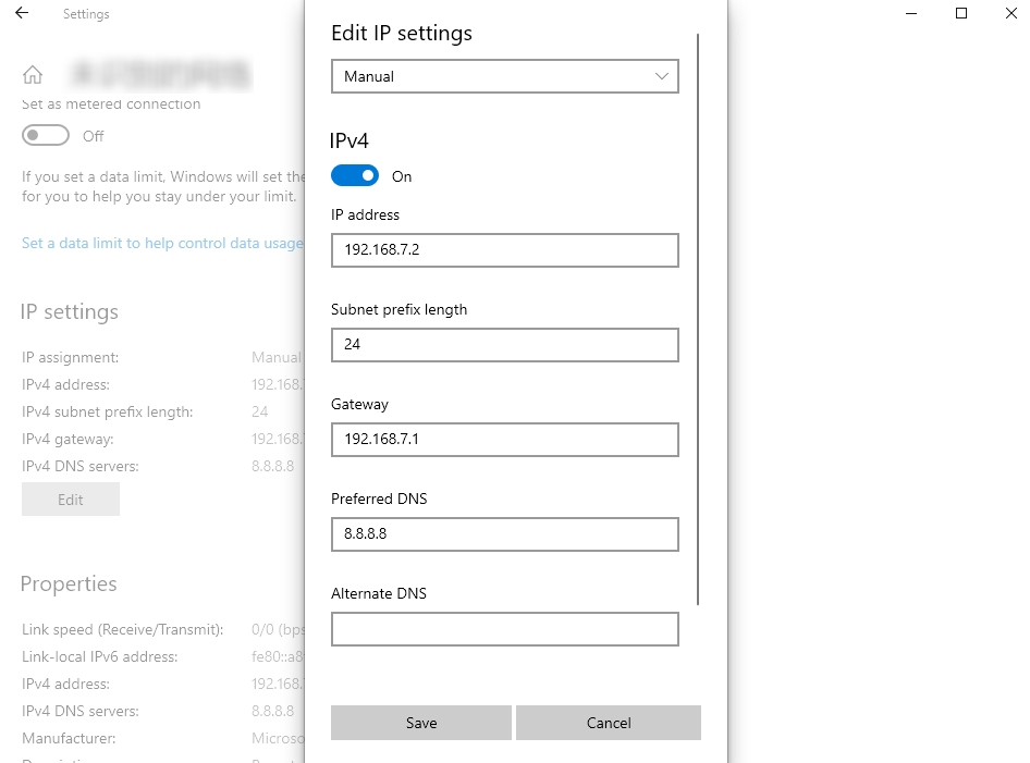

  1. Configure the USB network adapter IP on Windows.
Open Network Settings, locate the newly added unidentified network, manually set the IP address to an address in the same subnet as Quectel Pi H1 (e.g., 192.168.7.2), and save.
  1. Test connectivity:
ping 192.168.7.1

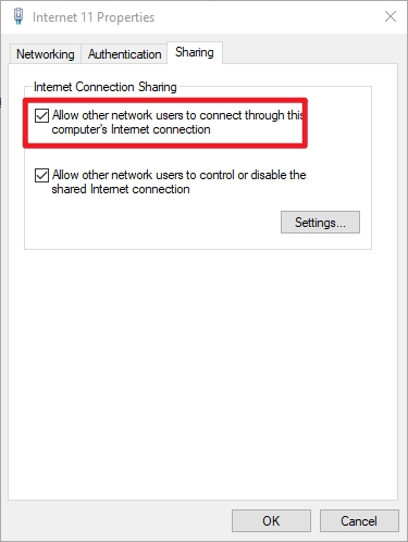

  1. Open the Network Connections page: Press Win + R, type ncpa.cpl, and press Enter.
  2. Enable Internet Connection Sharing: Right-click the network adapter that currently has internet access (e.g., WLAN or Ethernet), select Properties → Sharing tab, check Allow other network users to connect through this computer's Internet connection.

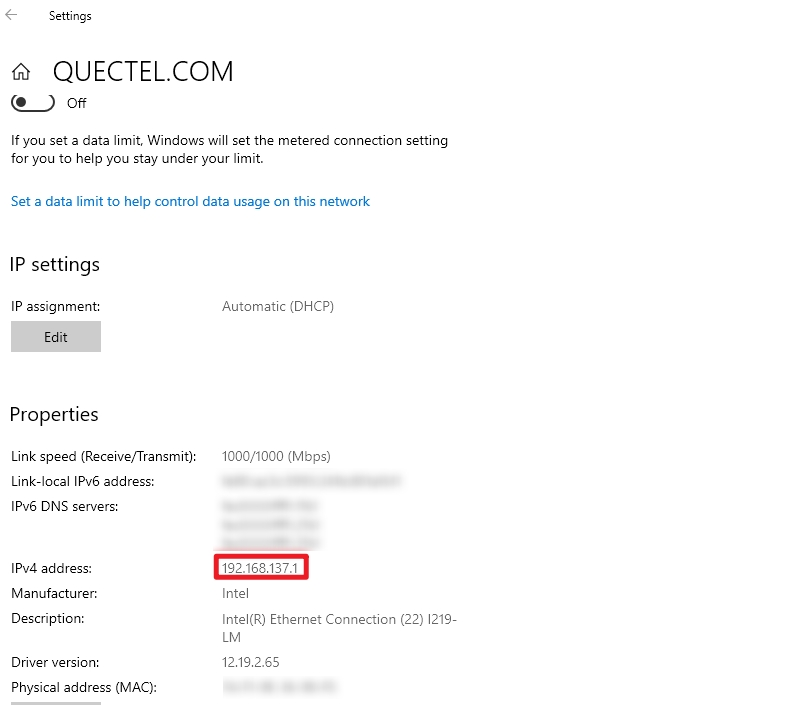

    After enabling sharing, Windows typically sets the USB RNDIS adapter address to 192.168.137.1/24.
  3. Reconfigure the usb0 IP on Quectel Pi H1 (must match the subnet assigned by Windows):
