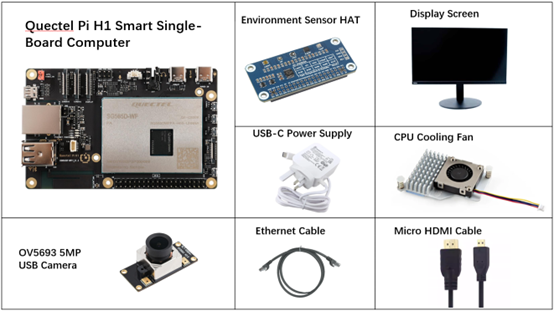

Development Accessories List
The development accessories are provided for reference only. Different development environments may vary. For example, if development is performed via an SSH remote connection, the USB expansion board is not required, and the display can also be replaced as needed.
Accessory Name Quantity Specifications
Quectel Pi H1 Smart Single-Board Computer 2 Quectel Pi H1 Smart Single-Board Computer
Environment Sensor HAT 1 Environment Sensor HAT
OV5693 5MP USB Camera 1 OV5693 5MP USB Camera
USB-C Power Supply 1 27W USB Type-C Interface Charger 1.2m Cable Length Standard Power PD Power Supply Suitable for Raspberry Pi 5
CPU Cooling Fan 1 Raspberry Pi 5 Official Active Cooler with Heatsink and Thermal Pad
USB-C DP Cable / Micro HDMI Cable 1 Spec: DP 1.4; Length: 1m; USB-C (male) to USB-C (male)
Spec: Micro HDMI 2.0 ; Length: 1m; HDMI-A (male) to HDMI-D (male)
Ethernet Cable 1 Length: 1m; Transmission Rate: Gigabit
Display Screen 1 24-inch HDMI Monitor

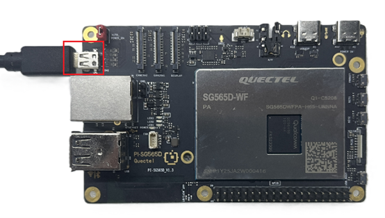

1.Display Connection
Connect one end of the Micro HDMI cable to the Micro HDMI port of the Quectel Pi H1 Smart Single-Board Computer, and connect the other end to the display's HDMI port.

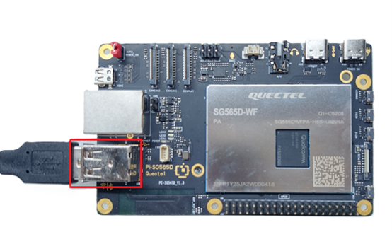

Connect the USB keyboard and mouse to the two USB-A ports on the Quectel Pi H1 Smart Single-Board Computer. If you are using wireless input devices, simply plug the receiver into a USB port.

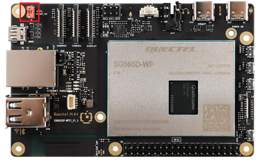

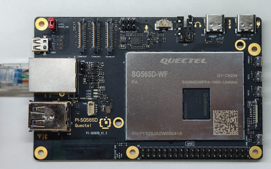

4.Jumper Cap Connection
On the header pins at the upper-left corner of the Quectel Pi H1 Smart Single-Board Computer labeled AUTO_POWER_ON, make sure the pins are shorted with a jumper cap.

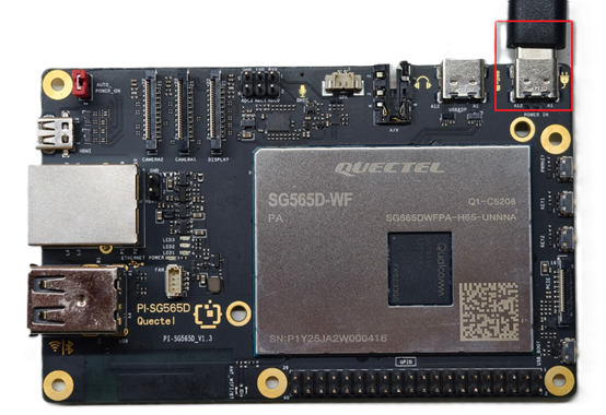

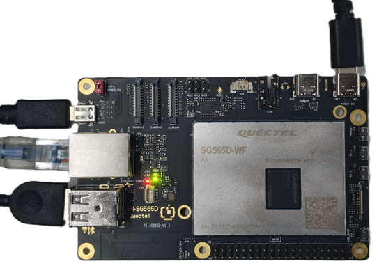

5.Power Connection
Connect the USB-A end of the power cable to the power adapter, and connect the USB-C end to the power input port of the Quectel Pi H1 Smart Single-Board Computer (labeled POWER IN).
6.Reference for completed connections

2.Jumper Cap Connection

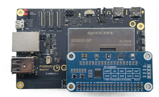

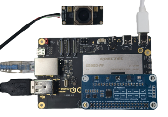

3.Environmental Sensor Expansion Board Connection
Connect the environmental sensor expansion board to the 40-pin header of the Quectel Pi H1 Smart Single-Board Computer.

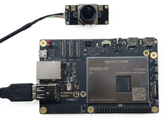

4.Camera Connection
Connect the USB camera to a USB-A port.
5.Power Connection

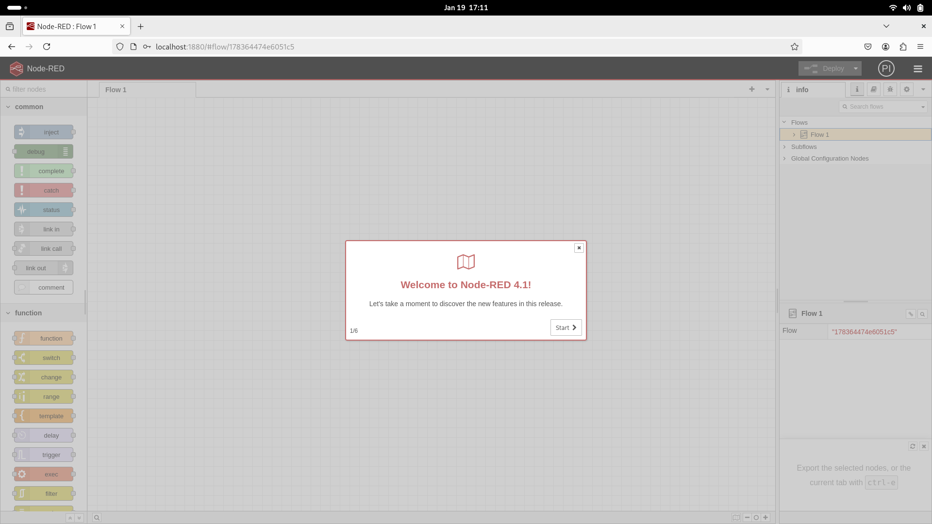

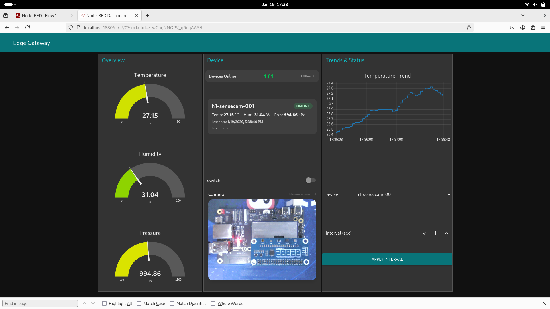

5.Accessing the Dashboard
If you are using a browser on the Pi desktop, open: http://localhost:1880/.
If you are browsing from another machine, use the Pi’s hostname or IP address. You can find the IP address by running hostname -I on the Pi, then access: http://<hostname>:1880.
The web interface is shown in the figure below:

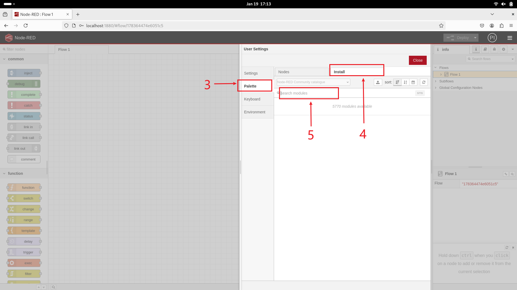

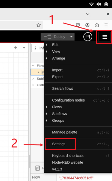

Install the required nodes:
After entering the editor, click the top-right menu, then go to Settings → Palette → Install to open the node installation page. Search for the nodes below and install them.
node-red-node-sqlite
node-red-dashboard

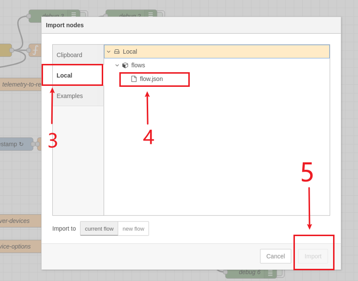

6.Import the Node-RED Flow
1.Place the flow.json file from flow.json under .node-red/lib/flows/.
cd ~/.node-red/lib/flows/

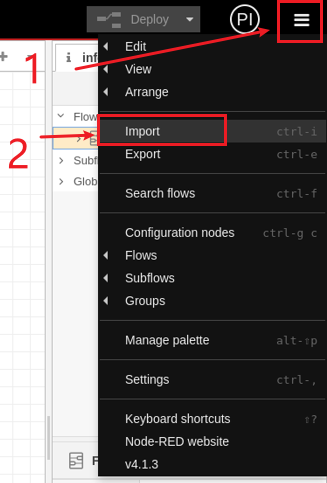

2.In the editor UI, click the top-right menu, then select Import → Local, choose flow.json, and click Import.
3.After importing the flow, click Deploy to apply the changes.

Application Demo

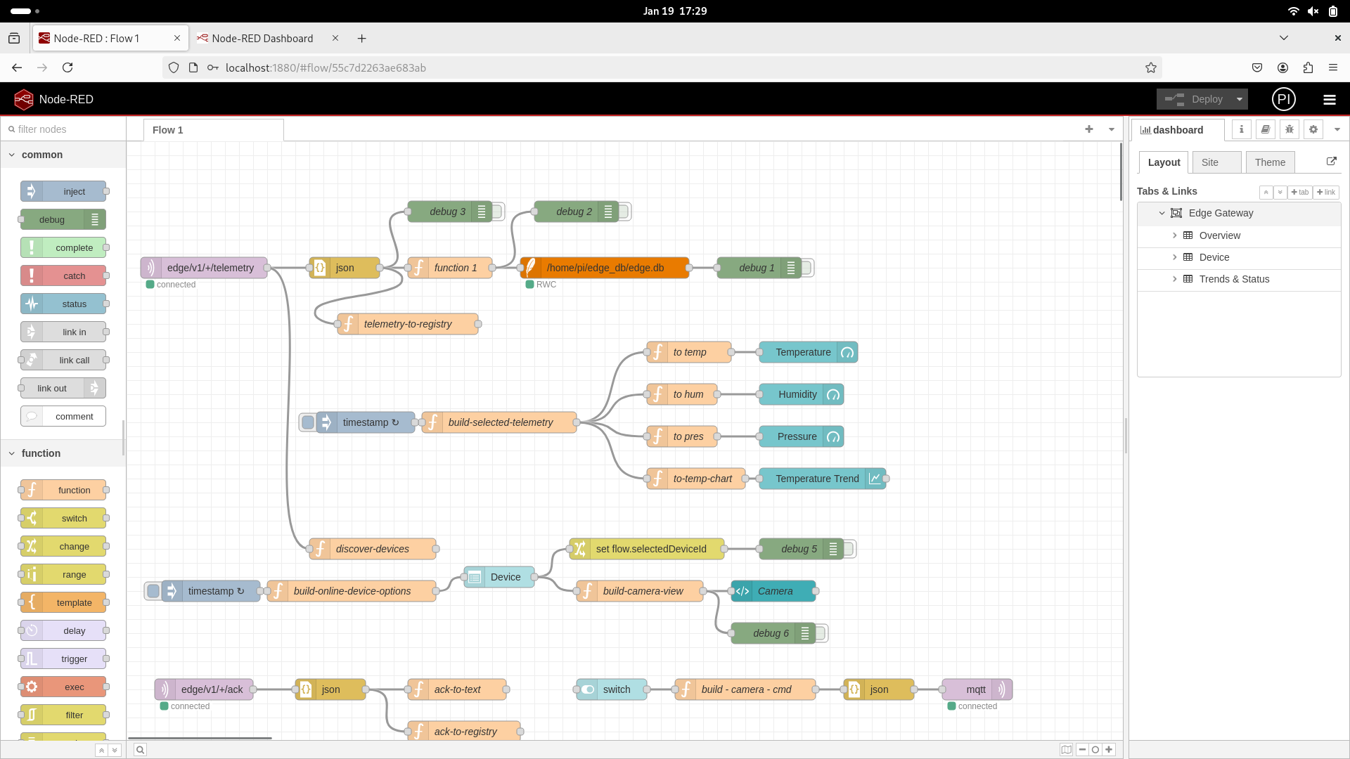

Node-RED UI
Node-RED editor URL: http://<hostname>:1880
Node-RED UI URL: http://<hostname>:1880/ui

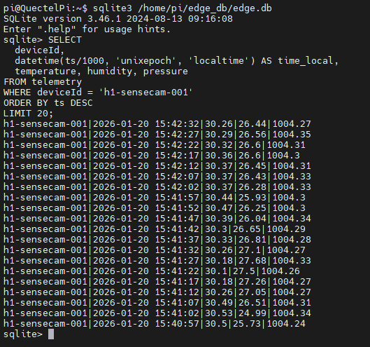

Enter the database
sqlite3 /home/pi/edge_db/edge.db
List tables and view the table schema
.tables
.schema telemetry
View the latest records
Replace h1-sensecam-001 with the actual device ID:
SELECT deviceId, ts, gatewayTs, temperature, humidity, pressure
FROM telemetry
WHERE deviceId = 'h1-sensecam-001'
ORDER BY ts DESC
LIMIT 20;
Convert timestamps to human-readable time
ts is in milliseconds.
SELECT
  deviceId,
  datetime(ts/1000, 'unixepoch', 'localtime') AS time_local,
FROM telemetry
ORDER BY ts DESC
LIMIT 20;
