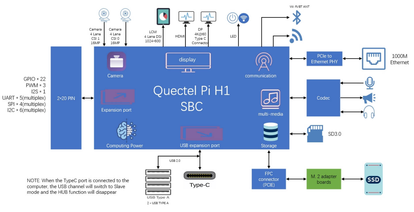

Functional block diagram

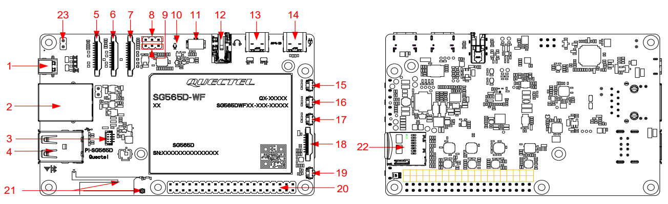

Interface description
Detailed interface diagram
Interface description table
No. Interface name Description
1 Micro HDMI Micro HDMI video output interface, supports 4k @ 60 Hz
2 Ethernet Supports 10/100/1000 Mbps Ethernet
3 Fan connector 5V fan power connector
4 USB Type-A 2 standard USB 2.0 Type-A interfaces
5, 6 Camera interface 2 channels of 4-lane MIPI CSI, the maximum data rate is 2.5 Gbps/ lane
7 DSI display interface 1 channel of 4-lane MIPI DSI D-PHY 1.2, 1280 × 800 @ 60 fps, the maximum data rate is 2.5 Gbps/lane
8 UART Debugs UART, for debugging only
9 ADC 3 channels of ADC test interface pins, maximum input voltage 1.8 V
10 DMIC Digital microphone
11 Speaker Speaker output, 2-pin 1.25 mm pitch universal speaker connector
12 Headphone 3.5 mm audio interface, audio output
13 USB Type-C Display interface: USB Type-C interface (DP Over USB Type-C), DisplayPort 1.4, maximum 4K (3840 × 2160) @ 60 fps
expansion interface: USB 3.1 Type-C interface, compatible with USB 2.0
14 USB Type-C power supply DC power input via USB Type-C; supports PD protocol
15 PWRKEY button Power on/off button, need to long press this button to power on when the "auto power-on" function is not enabled
16 KEY1 User-definable function
17 KEY2 User-definable function
18 PCIe PCIe 3.0 interface for high-speed peripherals, the maximum data rate is 8 Gbps
19 USB_BOOT Forces the product to enter download mode
20 2 × 20-pin header Multi-function GPIO header; multiplexed with I2C, SPI, PWM, etc.
21 Wi-Fi/Bluetooth PCB on-board antenna
RF Coaxial connector
Wi-Fi/Bluetooth PCB on-board antenna or RF coaxial connector ECT818000500
22 SD card Push-type SD card slot, compliant with SD 3.0 protocol
23 Auto power-on switch Switch for "auto power-on" function when powered
  • Two antenna options are available: Wi-Fi/Bluetooth PCB on-board antenna or RF coaxial connector. When the PCB on-board antenna is selected, the RF coaxial connector will not be soldered on the product.

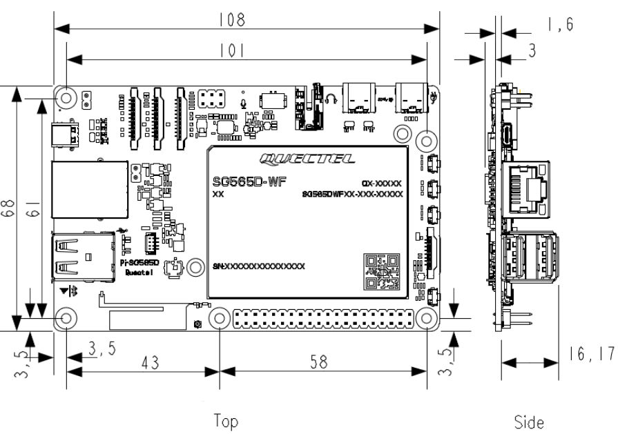

Mechanical dimensions
This section describes the mechanical dimensions of the product, all dimensions are in mm. For all dimensions without marked tolerances, the tolerance is +0.10/-0.15.
