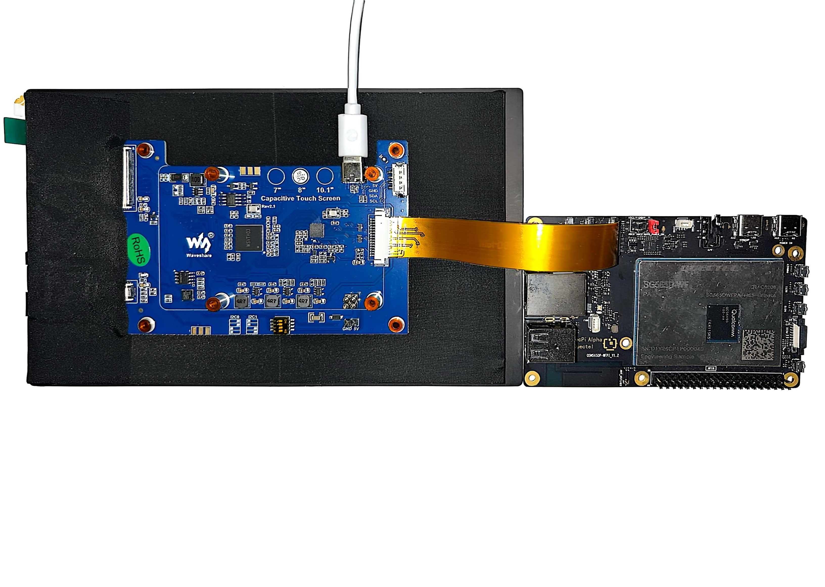

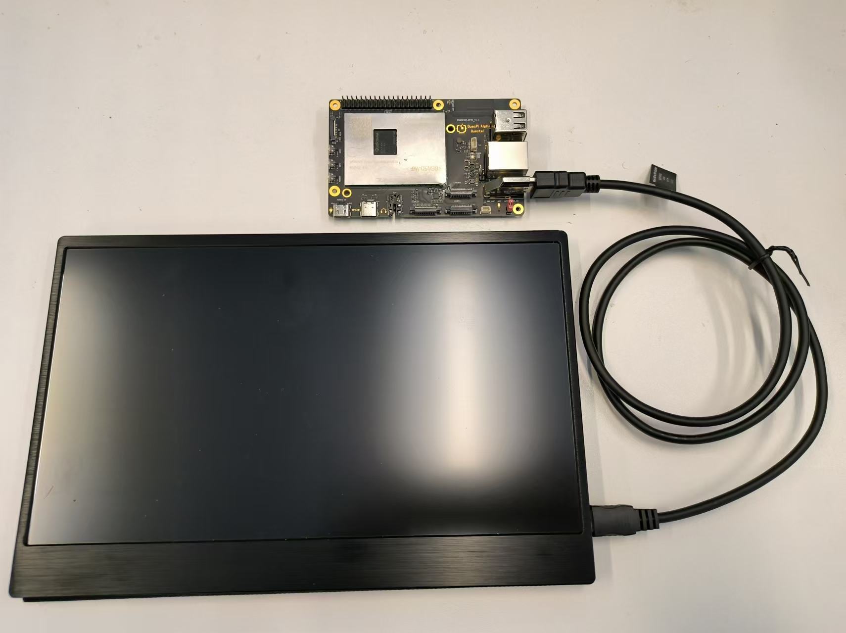

Connect Display
Prepare a display and connect it to Quectel Pi H1.
Run Command

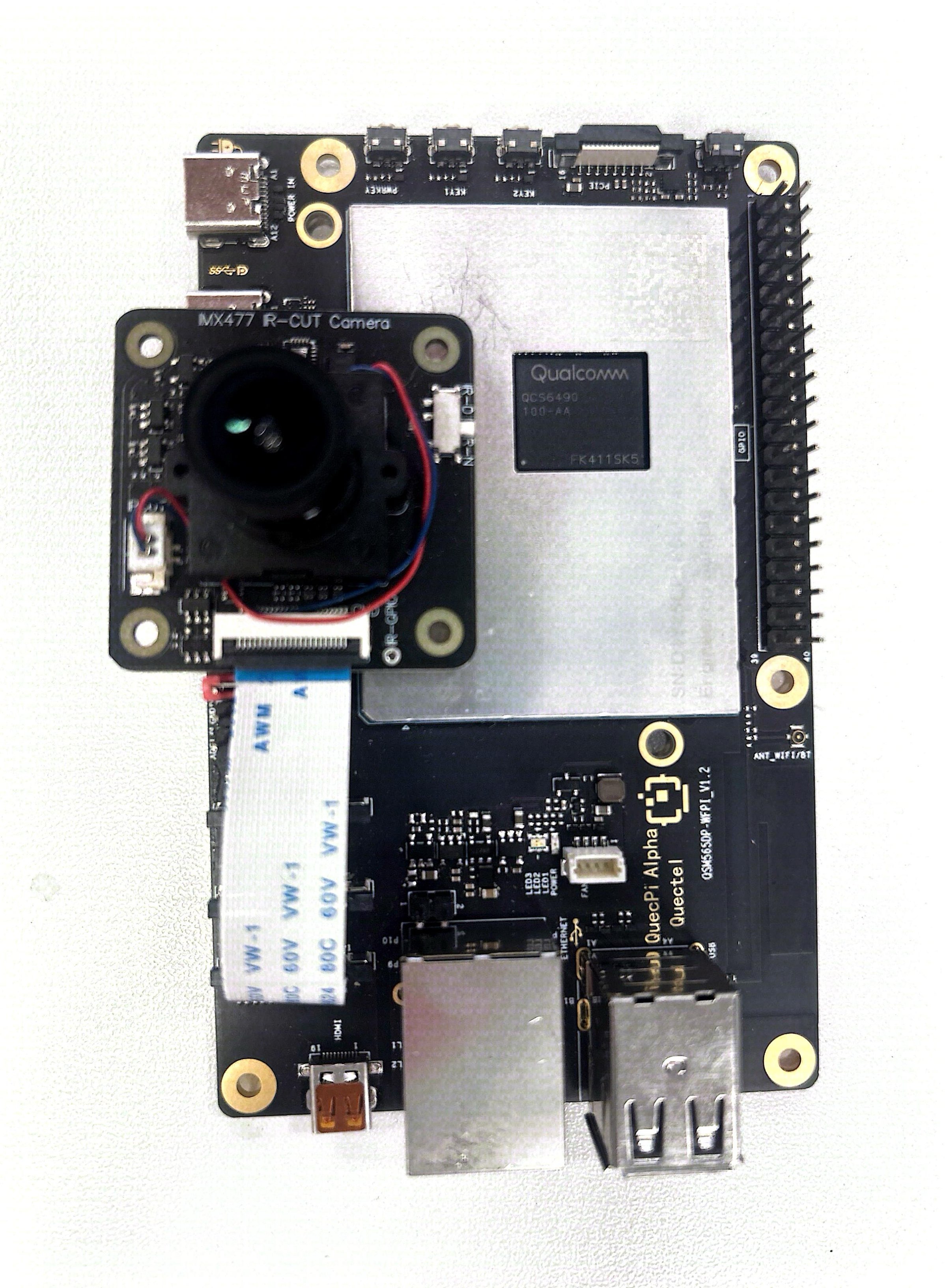

Connect Camera and Display
  • Prepare a MIPI camera,and connect it to the first CSI slot.
  • Prepare an HDMI display,and connect it to the development board.

Key Command Description
  • gst-launch-1.0:Builds GStreamer pipeline,The -e parameter after it ensures resources are released when finished.
  • qtiqmmfsrc:The camera source based on QMMF. camera=0 Indicates to select the first CSI interface.
  • tee name=split:Copies the original video stream for display and inference respectively.
  • qtimlvconverter:Converts NV12 video frames into model input tensors.
  • qtimltflite:Calls TensorFlow Lite + QNN delegate to accelerate model inference with HTP.
  • qtimlvpose:Performs pose decoding on inference results and output human keypoints.
  • qtioverlay/qtimetamux:Overlays keypoints onto video frames and output through waylandsink.
Run Results
After running the command, the display will show the camera stream and pose estimation results. Test Example

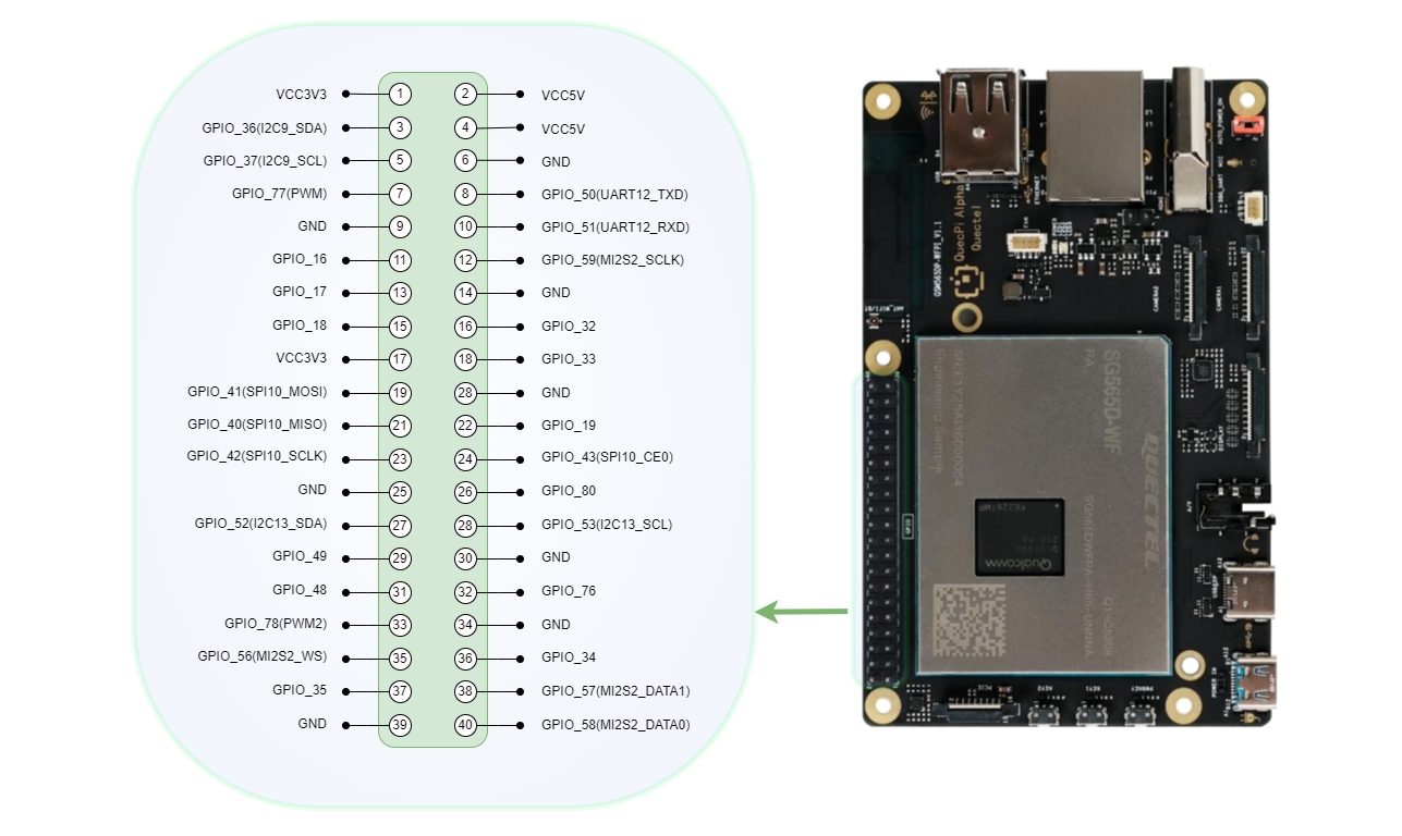

40PIN and Interface Expansion
The configuration file for 40PIN low-speed interfaces (i2c9/spi10/uart12_2w/i2c13/spi14) is located at /etc/qpi-config/qpi-config.ini. The configuration steps are:
  1. Modify the qpi-config.ini configuration
  2. Apply the configuration
qpi-config 40pin set
  1. Restart to take effect

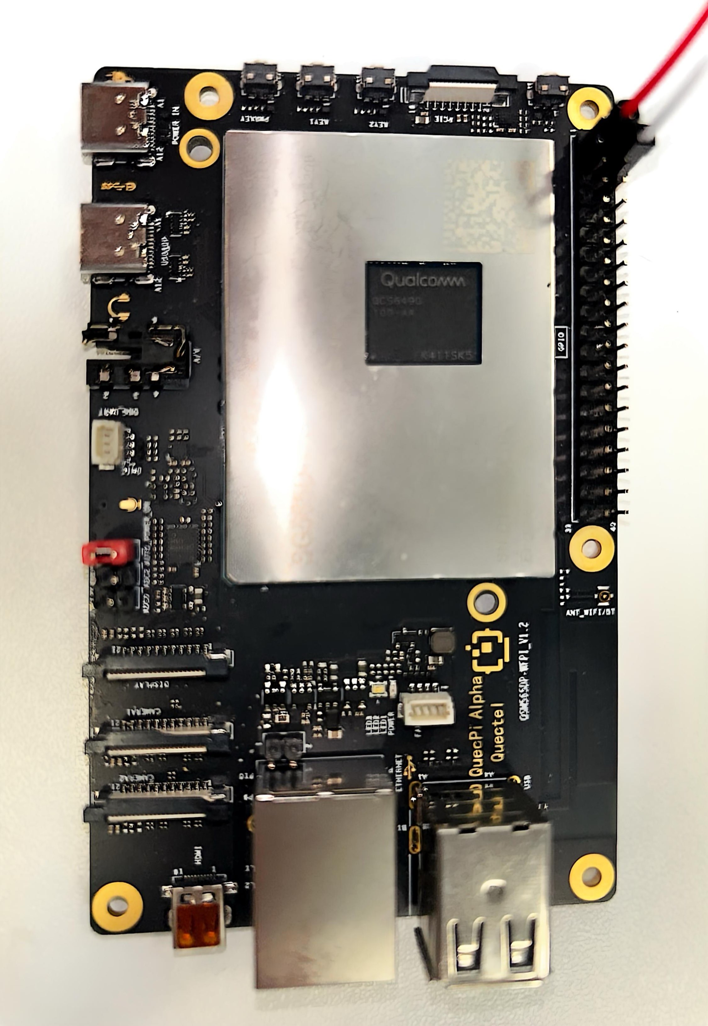

GPIO Testing

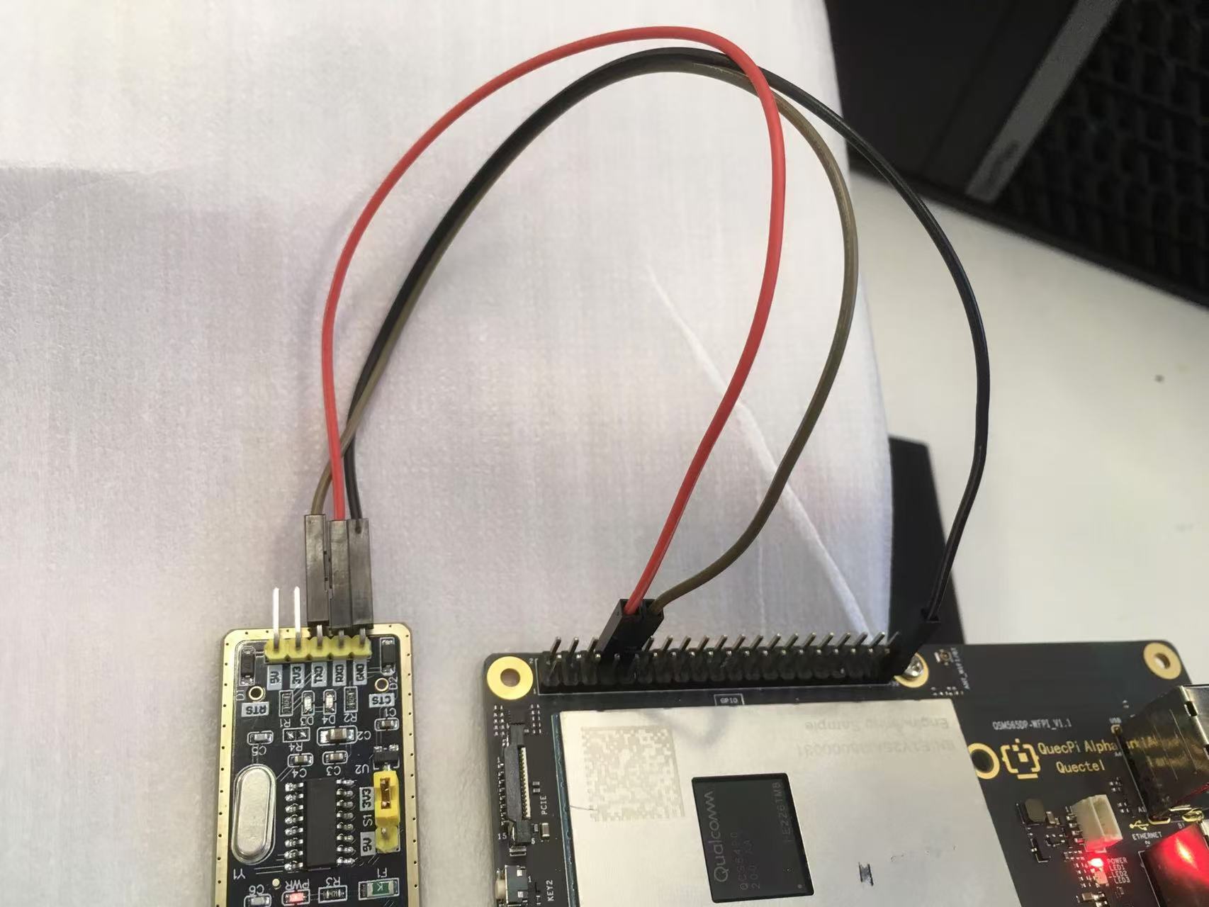

Select a 40-pin GPIO pin to test GPIO functionality. For example, select Pin3 of 40-pin for testing. Pin3 corresponds to gpio_num 36. The gpio_num information corresponding to each pin can be found in the pin mapping table.
Connection diagram,where the red wire connects to the multimeter positive terminal and the white wire connects to the multimeter negative terminal:
Control Using SHELL Commands
The system has lgpiod service enabled by default. Execute the following commands in sequence to test the GPIO functionality of Pin3 of 40-pin:
  • rgs c 999 go 4 #Use go to open /dev/gpiochip4.
  • rgs c 999 gso 0 36 #Use gso to set gpio 36 as output mode. In this command, 0 is the return value of the previous command, which shoule be modified according to actual situation.
  • rgs c 999 gw 0 36 0 #Set GPIO36 to low level. At this time, the pin voltage value is 0 V.
  • rgs c 999 gw 0 36 1 #Set GPIO36 to high level. At this time, the pin voltage value is 3.3 V.

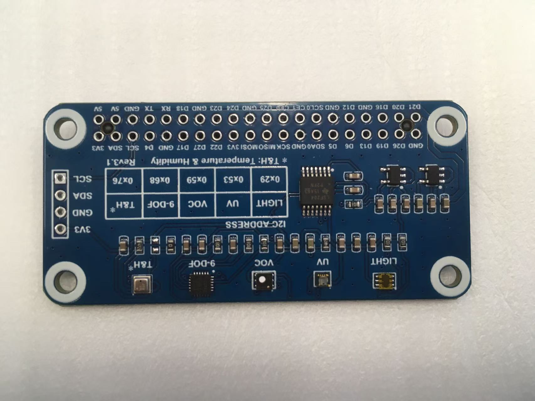

I2C Testing

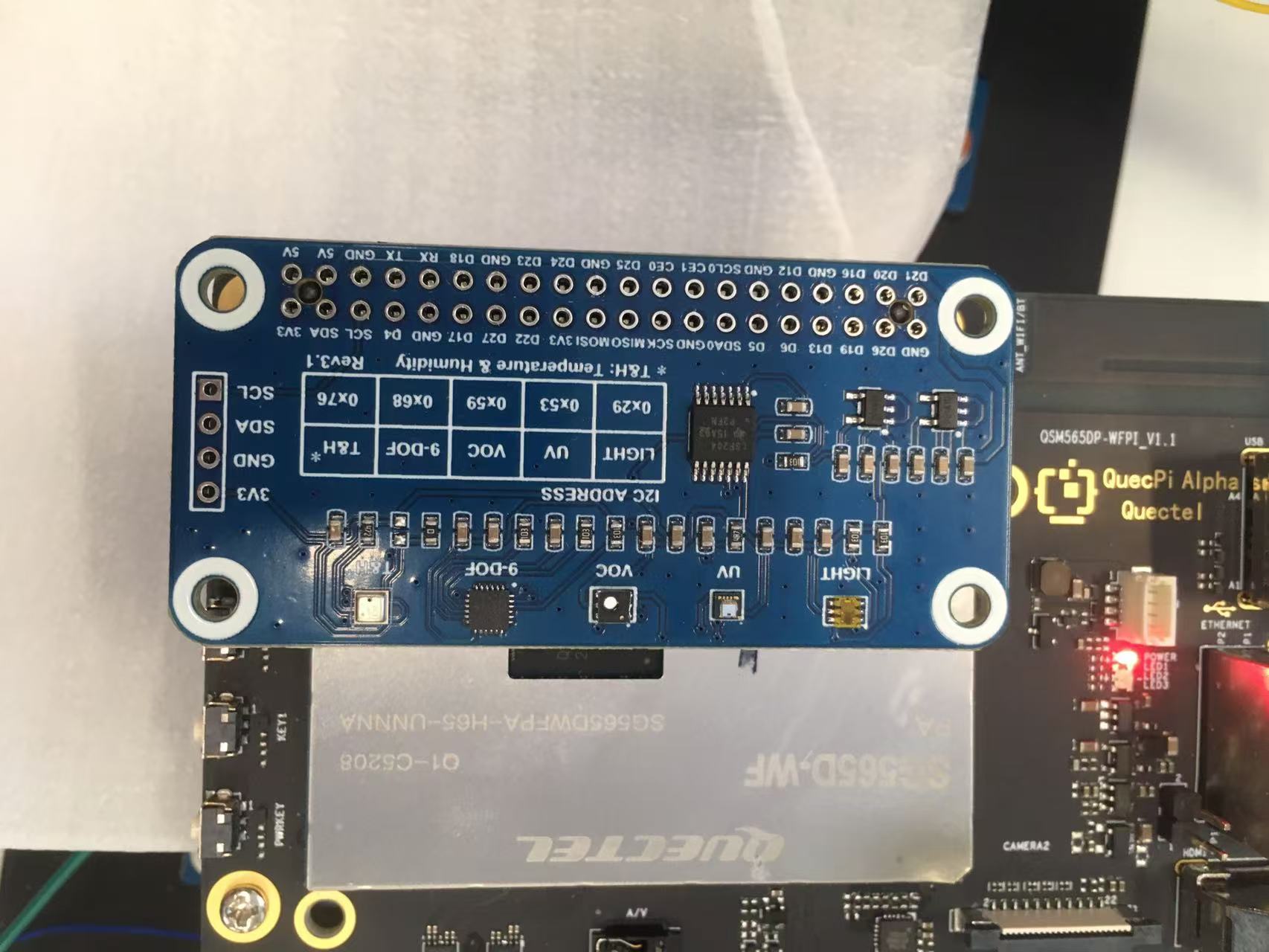

40PIN's pin3 and pin5 default to I2C data and clock pins, corresponding to device node /dev/i2c9. If the node does not appear, you can first use qpi-config from the beginning of this chapter to configure and enable it.
Testing I2C interface requires an external I2C device,Here we choose the Waveshare environmental sensor expansion board,connected via 40pin interface。
Connection diagram:
Waveshare Environmental Sensor Expansion Board
Image 2
QuecTel Pi H1 40PIN Pins
Image 3
Quectel Pi H1 with Environmental Sensor Expansion Board

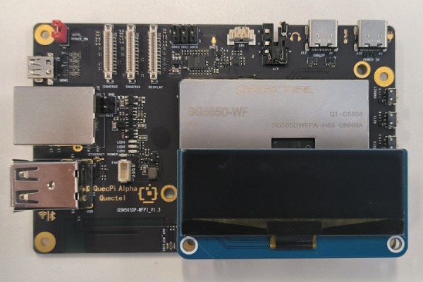

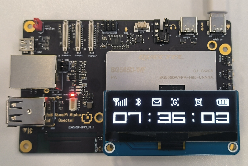

SPI Testing

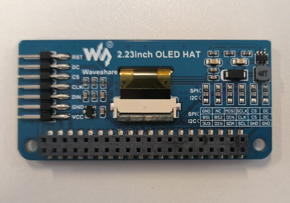

Use Waveshare 2.23 inch OLED displaytest SPI functionality in 40pin,corresponding device node /dev/spi10,If the node does not appear, you can first usefrom the beginning of this chapter qpi-config to configure and enable。
Connection diagram:
Image 2
Quectel Pi H1 40PIN Pins
Test steps:
  • wget https://www.waveshare.net/w/upload/c/c5/2.23inch-OLED-HAT-Code.7z #Download the source code provided by Waveshare
  • 7z x 2.23inch-OLED-HAT-Code.7z #Extract the source code
  • cd 2.23inch-OLED-HAT-Code/Without\ scrolling/Raspberry\ Pi/SPI/c #Switch to the source code directory
  • Modify the source code according to the following patch content:
    diff -r -u "2.23inch-OLED-HAT-Code/Without scrolling/Raspberry Pi/c/examples/main.c" quectelpi/c/examples/main.c
    --- "2.23inch-OLED-HAT-Code/Without scrolling/Raspberry Pi/c/examples/main.c"	2023-12-20 03:19:38.000000000 +0000
    +++ quectelpi/c/examples/main.c	2025-08-15 07:34:39.959415415 +0000

         SSD1305_display();
    Only in quectelpi/c/lib/Config: .DEV_Config.h.un~
    diff -r -u "2.23inch-OLED-HAT-Code/Without scrolling/Raspberry Pi/c/lib/Config/DEV_Config.h" quectelpi/c/lib/Config/DEV_Config.h
    --- "2.23inch-OLED-HAT-Code/Without scrolling/Raspberry Pi/c/lib/Config/DEV_Config.h"	2023-12-20 03:23:11.000000000 +0000
    +++ quectelpi/c/lib/Config/DEV_Config.h	2025-08-15 07:32:05.844626084 +0000
    @@ -41,8 +41,8 @@
     //OLED Define
     #define OLED_CS         8
    -#define OLED_RST        25
    -#define OLED_DC         24
    +#define OLED_RST        19
    +#define OLED_DC         33
  • Compile: make
  • Run: ./main
  • The running effect is shown in the figure below:
UART Testing
40PIN's pin8 and pin10 are default configured as uart functionality, corresponding to device node /dev/ttyHS2. If the node does not appear, you can first use qpi-config from the beginning of this chapter to configure and enable it.
Connect the computer's USB to serial port rx to pin8, tx to pin10。
Connection diagram: ![](./images/40pin-pin8.jpg)
Control Using C Code
  • Create a uart.c file with the following content:
    #include <stdio.h>
    #include <string.h>
    #include <lgpio.h>
    int strip_head_and_tail(char *data, int data_len)
        int found_tail = 0;
        if (data_len > 0 && data[0] == '\r') {
            bcopy(data + 1, data, data_len-1);
            data_len--;
        if (data_len > 0 && data[0] == '\n') {
            data_len--;
        if (data_len > 0 && data[data_len - 1] == '\r') {
            data_len--;
            data[data_len] = 0;
            found_tail = 1;
        if (data_len > 0 && data[data_len - 1] == '\n') {
            data_len--;
            data[data_len] = 0;
            found_tail = 1;
        return found_tail;
    int main(int argc, char **argv)
        int handle = lgSerialOpen("/dev/ttyHS2", 115200, 0);
        char data[512];
        int data_len = 0;
        for (;;) {
            int read_len = lgSerialRead(handle,
                data + data_len, sizeof(data) - data_len);
            if (read_len > 0) {
                data_len += read_len;
            if (strip_head_and_tail(data, data_len)) {
                printf("received: %s\n", data);
                lgSerialWrite(handle, "Received.\r\n", 11);
            lguSleep(100);
        lgSerialClose(handle);
  • Compile: gcc -o uart uart.c -llgpio
  • Run: ./uart #At this time, the USB-to-serial-port module is connected to the PC. Use putty or other software that supports serial communication to communicate with the serial port server program. You can input content and end with Enter key in the client(such as putty). The server program will print the user input content and return "Received." to the client.
Control Using Python Script
  • Create server program uart.py file with the following content:
    import serial
    import threading
    PORT = '/dev/ttyHS2'
    BAUDRATE = 115200
    TIMEOUT = 1
    ser = serial.Serial(PORT, BAUDRATE, timeout=TIMEOUT)
    def read_and_echo(ser):
        while True:
            data = ser.readline()
            if data:
                print(f"Received: {data.decode().strip()}")
                ser.write(“Received.\r\n”)
    def main():
        if ser.is_open:
            print(f"Serial port {PORT} is open. Echo service started.")
            thread = threading.Thread(target=read_and_echo, args=(ser,))
            thread.daemon = True
            thread.start()
            try:
                while True:
                    pass
            except KeyboardInterrupt:
                print("Exiting program.")
        else:
            print(f"Failed to open serial port {PORT}.")
        ser.close()
        print(f"Serial port {PORT} is closed.")
    if __name__ == "__main__":
        main()
  • Run: python uart.py #At this time, the USB-to-serial-port module is connected to PC. Use putty or other software that supports serial communication to communicate with the serial port server program. You can input content and end with Enter in the client (such as putty). The server program will print the input content and return "Received." to the client.
PWM Testing
Pin33 of 40-pin is default configured as PWM functionality. Here we choose Waveshare's 4-pin PWM protocol speed control fan as the test device.

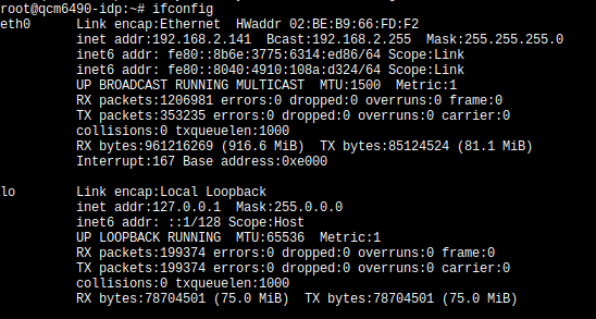

Use ifconfig to view network interface addresses:

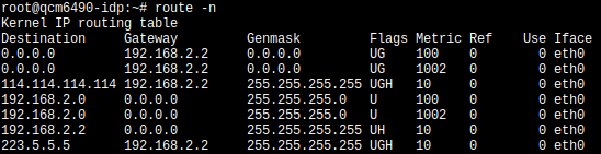

Use route -n to view network routing information,which contains default gateway address information:

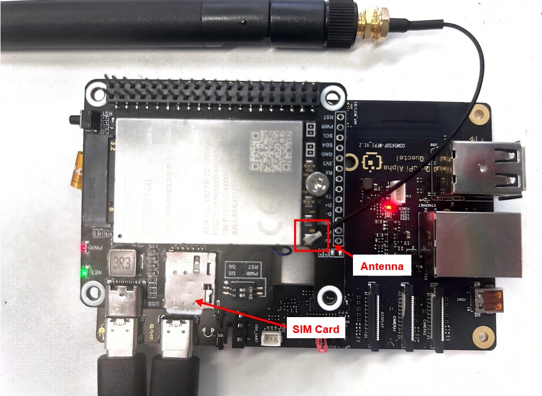

PCIe 5G Module Connection
The Quectel Pi H1 smart single-board computer can connect to a 5G network card via PCIe interface through a riser card. This chapter introduces how to use a PCIe riser card to connect RM520N-GL PCIe network card.
PCIe Module Configuration
To use the PCIe riser card, the 5G module needs to be set to PCIe-EP mode so that it can communicate with the PCIe interface of Quectel Pi H1. After installing the 5G module driver, connect Quectel Pi H1 to the 5G module through the riser card's USB port, and input AT command to switch it to PCIe-EP mode.
  1. Use a Type-C to USB cable to connect to a Windows computer (At this time you may need to install the driver. The driver file is provided by Quectel technical support. Please select the appropriate driver file for installation according to the corresponding 5G module).
  1. Use the serial port tool to open the module AT port.
You can view the port in Device Manager of the host. The port is "Quectel USB AT Port(COM***)".
AT+QCFG="data_interface",1,0
AT+QCFG="pcie/mode",0
AT+QCFG="usbnet",2
AT+CFUN=1,1
After executing the command, unplug the PC USB port. After re-powering Quectel PI H1, use the following command through the shell port to determine if the device is properly recognized and connected.
root@qcm6490-idp:~# lspci
0000:00:00.0 PCI bridge: Qualcomm Device 010b
0000:01:00.0 Ethernet controller: Device 1f0a:6801 (rev 01)
0001:00:00.0 PCI bridge: Qualcomm Device 010b
0001:01:00.0 Unassigned class [ff00]: Qualcomm Device 0308
root@qcm6490-idp:~# ls /dev/mhi*
/dev/mhi_BHI  /dev/mhi_DIAG  /dev/mhi_DUN  /dev/mhi_LOOPBACK  /dev/mhi_QMI0
If all the above devices are recognized, then dialing can be performed normally.
Dial-up and Network Registration
Use the quectel-CM tool for dial-up. First connect the antenna to the 5G module and insert a SIM card to avoid poor signal and inability to register to the network.
After confirming everything is correct, directly run the quectel-CM command in the background for dialing.
root@qcm6490-idp:~# quectel-CM &
[2] 1303
root@qcm6490-idp:~# [01-01_00:07:55:168] QConnectManager_Linux_V1.6.7
[01-01_00:07:55:179] network interface '' or qmidev '' is not exist
[01-01_00:07:55:179] netcard driver = pcie_mhi, driver version = V1.3.7
[01-01_00:07:55:179] qmap_mode = 1, qmap_version = 9, qmap_size = 15360, muxid = 0x81, qmap_netcard = rmnet_mhi0.1
[01-01_00:07:55:179] Modem works in QMI mode
[01-01_00:07:55:193] /proc/1273/fd/7 -> /dev/mhi_QMI0
[01-01_00:07:55:193] /proc/1273/exe -> /usr/bin/quectel-CM
[01-01_00:07:55:193] requestDeactivateDefaultPDP WdsConnectionIPv4Handle
[01-01_00:07:55:424] ip link set dev rmnet_mhi0 down
[01-01_00:07:55:431] ip addr flush dev rmnet_mhi0.1
[01-01_00:07:55:436] ip link set dev rmnet_mhi0.1 down
[01-01_00:07:55:457] QmiWwanThread exit
[01-01_00:07:55:459] qmi_main exit
[01-01_00:07:57:196] cdc_wdm_fd = 7
[01-01_00:07:57:208] Get clientWDS = 15
[01-01_00:07:57:212] Get clientDMS = 1
[01-01_00:07:57:215] Get clientNAS = 4
[01-01_00:07:57:219] Get clientUIM = 3
[01-01_00:07:57:224] Get clientWDA = 1
[01-01_00:07:57:229] requestBaseBandVersion RM520NGLABR03A02M8G
[01-01_00:07:57:232] qmap_settings.rx_urb_size = 15360
[01-01_00:07:57:233] qmap_settings.ul_data_aggregation_max_datagrams  = 11
[01-01_00:07:57:233] qmap_settings.ul_data_aggregation_max_size       = 8192
[01-01_00:07:57:233] qmap_settings.dl_minimum_padding                 = 0
[01-01_00:07:57:248] requestGetSIMStatus SIMStatus: SIM_READY
[01-01_00:07:57:257] requestGetProfile[pdp:1 index:1] ctnet///0/IPV4V6
[01-01_00:07:57:261] requestRegistrationState2 MCC: 460, MNC: 11, PS: Attached, DataCap: 5G_SA
[01-01_00:07:57:265] requestQueryDataCall IPv4ConnectionStatus: DISCONNECTED
[01-01_00:07:57:265] ip link set dev rmnet_mhi0 down

root@qcm6490-idp:~# ifconfig
eth0      Link encap:Ethernet  HWaddr 00:55:7B:B5:7D:F7
          UP BROADCAST MULTICAST  MTU:1500  Metric:1
          RX packets:0 errors:0 dropped:0 overruns:0 frame:0
          TX packets:0 errors:0 dropped:0 overruns:0 carrier:0
          collisions:0 txqueuelen:1000
          RX bytes:0 (0.0 B)  TX bytes:0 (0.0 B)
          Interrupt:166
lo        Link encap:Local Loopback
          inet addr:127.0.0.1  Mask:255.0.0.0
          inet6 addr: ::1/128 Scope:Host
          UP LOOPBACK RUNNING  MTU:65536  Metric:1
          RX packets:50 errors:0 dropped:0 overruns:0 frame:0
          TX packets:50 errors:0 dropped:0 overruns:0 carrier:0
          RX bytes:4632 (4.5 KiB)  TX bytes:4632 (4.5 KiB)
p2p0      Link encap:Ethernet  HWaddr 02:03:7F:D6:00:01
          collisions:0 txqueuelen:3000
rmnet_mhi0 Link encap:UNSPEC  HWaddr 00-00-00-00-00-00-00-00-00-00-00-00-00-00-00-00
          inet6 addr: fe80::6921:e40e:336d:a80e/64 Scope:Link
          UP RUNNING NOARP  MTU:1500  Metric:1
          RX packets:14 errors:0 dropped:0 overruns:0 frame:0
          TX packets:23 errors:0 dropped:0 overruns:0 carrier:0
          RX bytes:4464 (4.3 KiB)  TX bytes:5204 (5.0 KiB)
rmnet_mhi0.1 Link encap:Ethernet  HWaddr 02:50:F4:00:00:01
          inet addr:192.168.134.67  Mask:255.255.255.248
          inet6 addr: fe80::50:f4ff:fe00:1/64 Scope:Link
          RX bytes:4330 (4.2 KiB)  TX bytes:5334 (5.2 KiB)
wlan0     Link encap:Ethernet  HWaddr 00:03:7F:50:00:01

HDMI Screen Testing
Quectel Pi H1 smart single-board computer supports HDMI interface display screen.
HDMI Screen Connection
Connect according to the following diagram:
11.6 inch HDMI Display Screen
Quectel Pi H1 after connecting HDMI display screen
Display Weston Desktop on HDMI Screen
After connecting the HDMI display and powering on, start the display service: systemctl start init_display. The HDMI screen will display the Weston desktop.
The display effect is shown in the figure below:

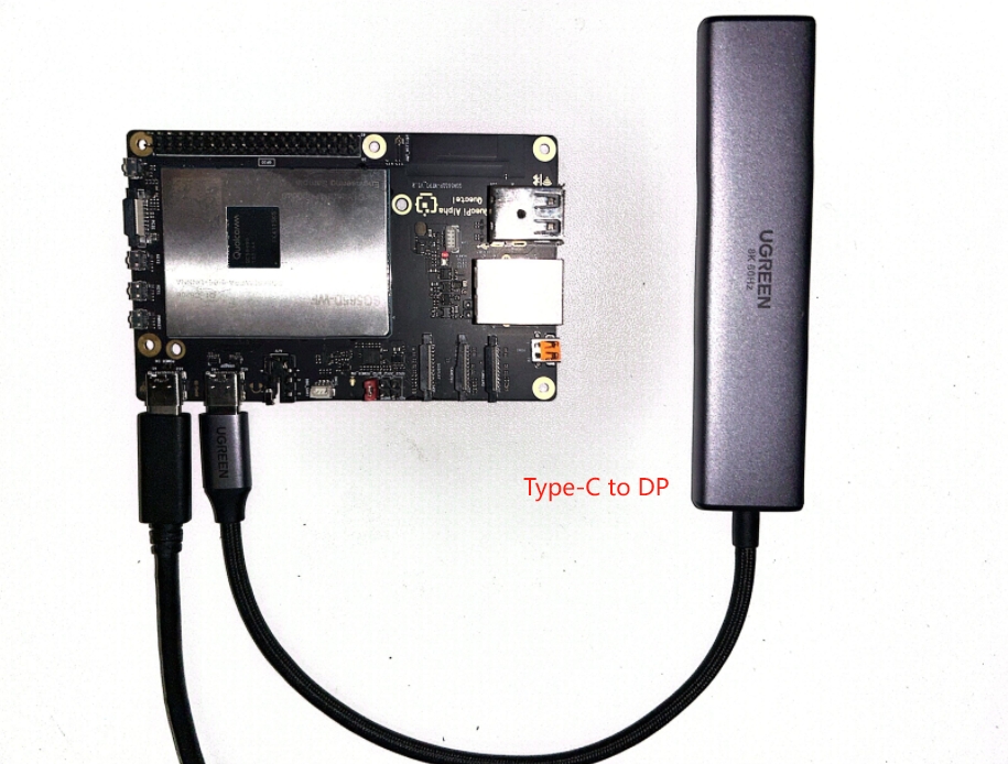

DP Screen Testing
Quectel Pi H1 smart single-board computer supports connecting display screens through the Type-C to DP interface.
MIPI Screen Connection

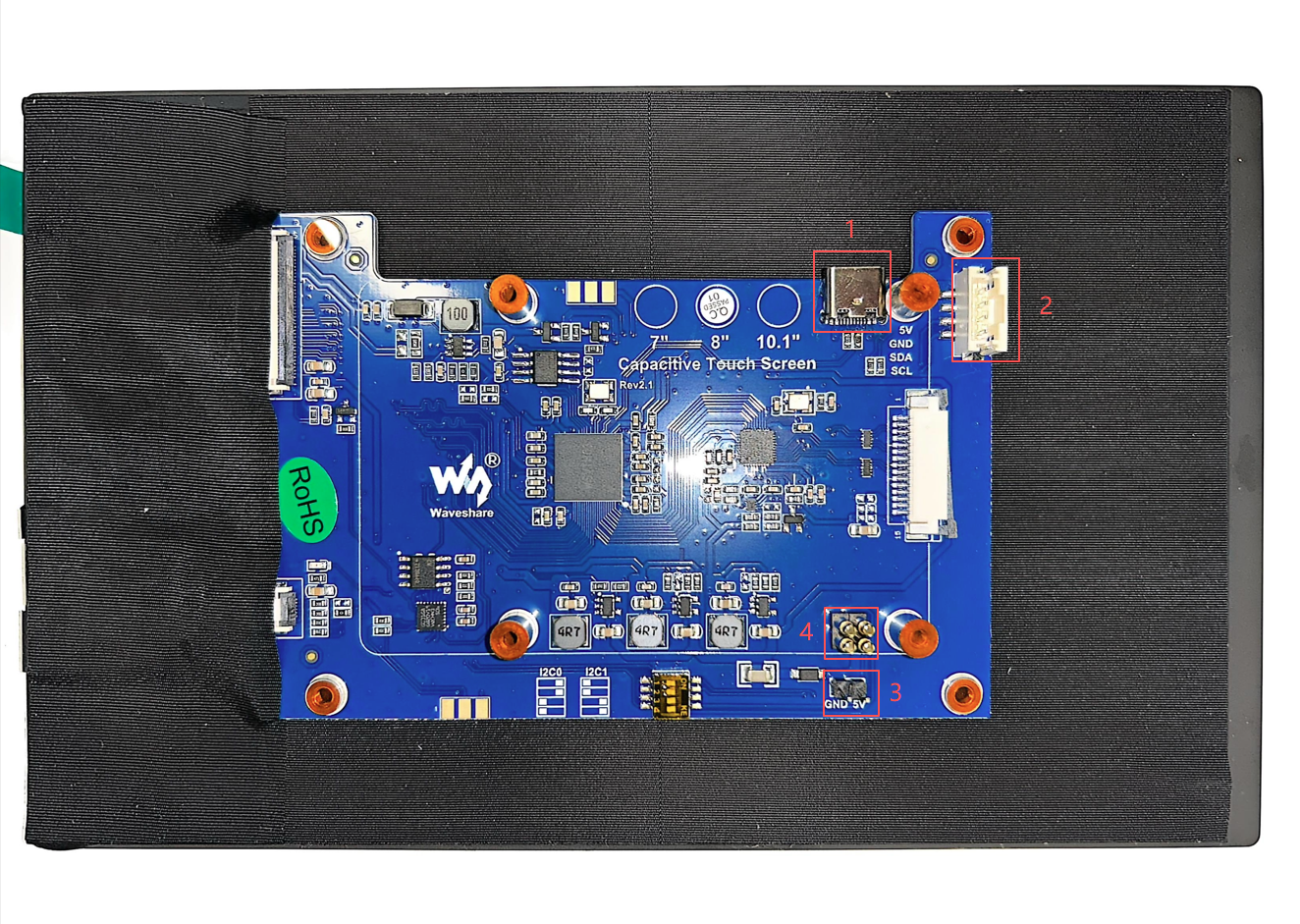

Note: This screen has 4 interfaces for power supply,any one can be selected,example selects“1”for power supply。
  1. namely type-C interface
  2. I2C communication and power supply interface
  3. 5V input and output interface
  4. I2C communication and power supply interface,need to align the screw holes with Quectel Pi H1 single board computer and tighten,Ensure the pins are firmly connected to 40PIN
Waveshare 8 inch MIPI Display Screen Back
Quectel Pi H1 after connecting MIPI display screen

MIPI Camera (IMX477) Testing

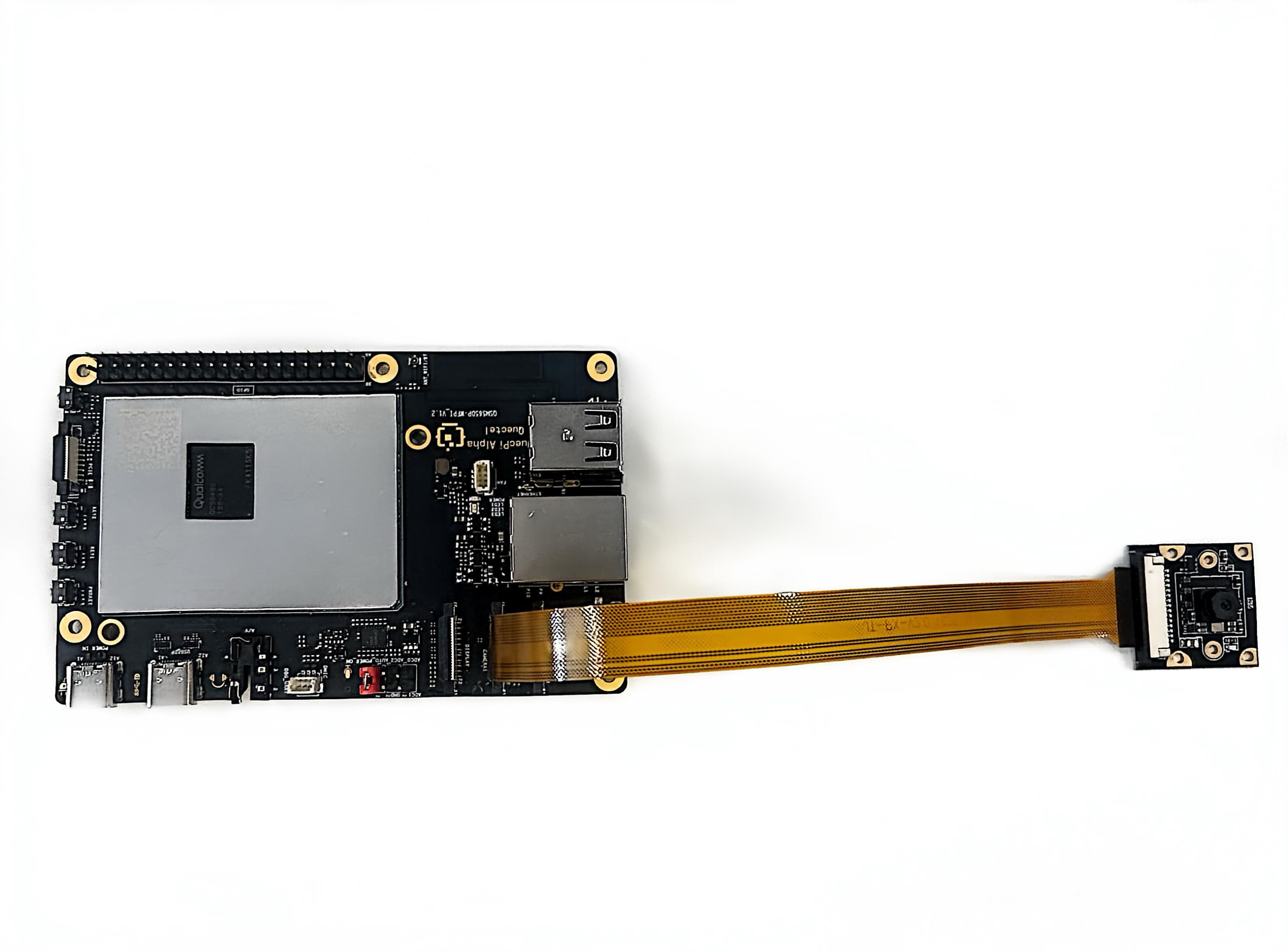

Quectel Pi H1 smart single-board computer supports MIPI interface camera. Below we select a Waveshare imx477 CSI interface CMOS camera as an example for testing.
Camera Connection
Connect according to the following diagram. When connecting, pull up the black lock part of the connector, insert the FPC cable into the second CSI slot. Note that the metal contact surface faces the metal contact surface inside the board. Press the lock to confirm that the FPC cable is stable and not loose.
Prerequisites
Run the following command in the SSH terminal:
mount -o rw,remount /

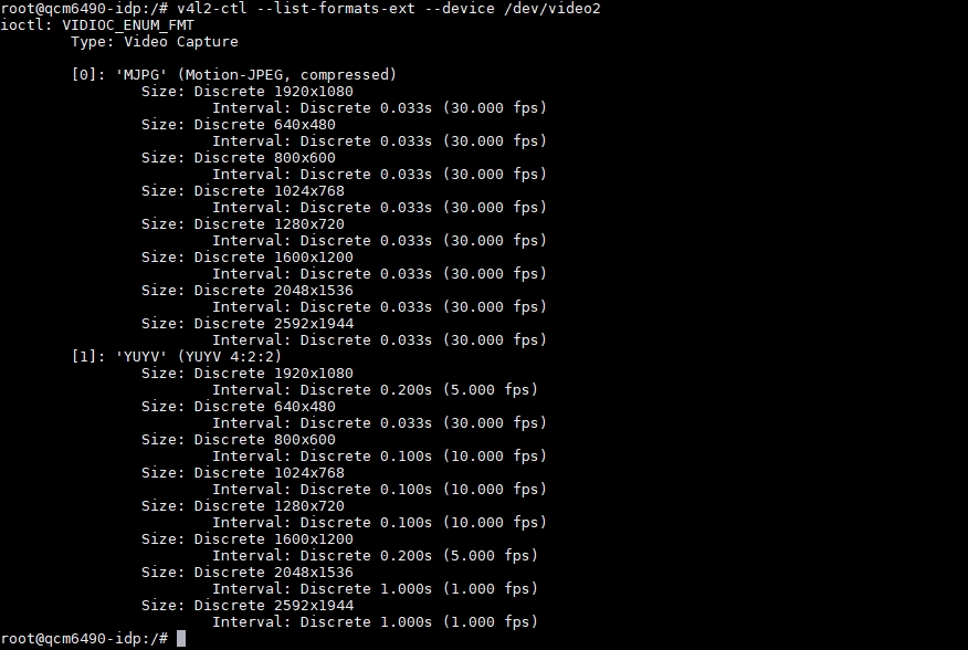

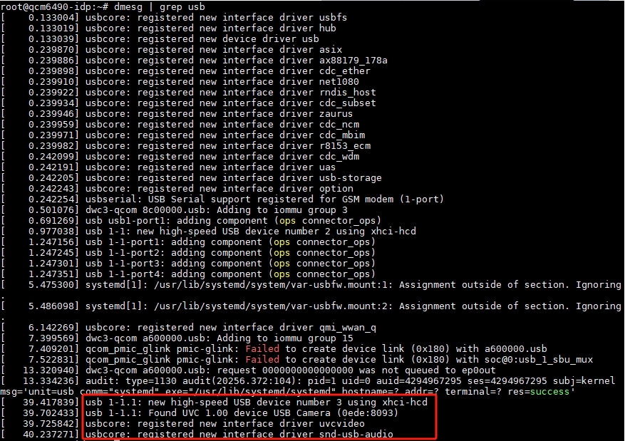

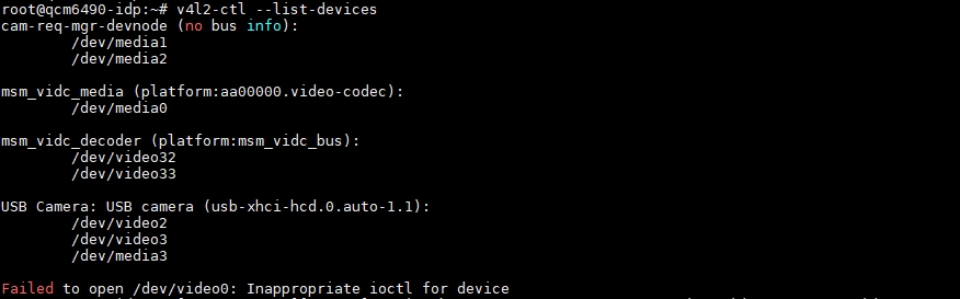

  1. Run the following command in the SSH terminal. You can view the USB device information recognized by the system:
dmesg | grep usb
  1. Run the following command in the SSH terminal. You can view newly added device nodes:
v4l2-ctl --list-devices
  • /dev/video2 —— Main video node, the gst command mainly operates on this node
  • /dev/video3 —— Metadata node
  • /dev/media3 —— Hardware topology controller that controls the entire pipeline
  1. Run the following command in the SSH terminal to view the formats supported by the video node:
v4l2-ctl --list-formats-ext --device /dev/video2
  • From the figure, it can be seen that the camera supports MJPG and YUYV of image output.

  1. Press CTRL+C to automatically save the last 5 images.
Command description:
  • v4l2src device=/dev/video2 io-mode=2
Capture MJPEG data from USB camera.
  • image/jpeg,width=1280,height=720,framerate=30/1
Require camera to output 1280×720@30 fps MJPEG stream.
  • tee name=t
Split the same stream into multiple streams, and subsequently use t. for reference.
  • t. ! queue ! jpegdec ! videoconvert ! waylandsink sync=false
Preview branch: Decode MJPEG → Convert to RGB → Send to Wayland window for real-time display. sync=false reduces delay.
  • t. ! queue ! multifilesink location=shot-%05d.jpg max-files=5
Photo capture branch: Save each frame as JPG unchanged,and the file name is automatically numbered to %05d (5 digits). max-files=5 means to only keep the latest 5 images, and that old files are automatically deleted.

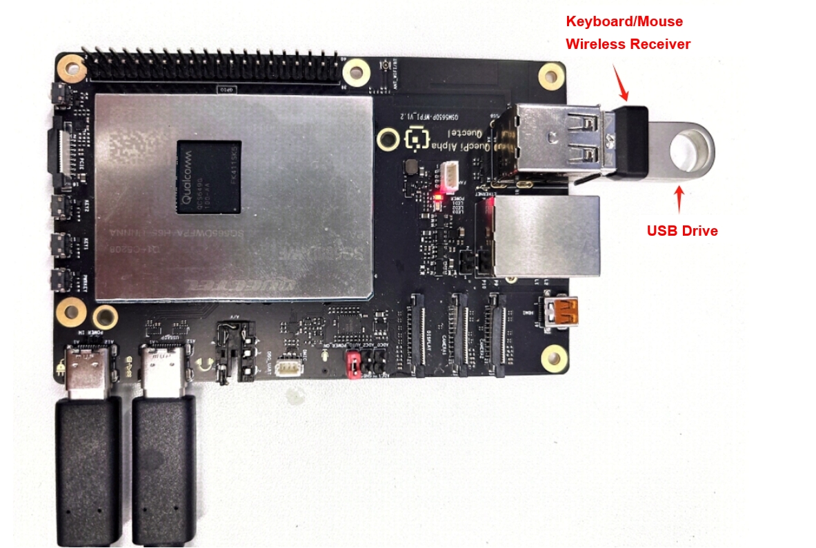

USB and Extended Peripherals
USB Host Testing
USB Host refers to a system or hardware that can control and manage USB devices. It is responsible for providing power, data transmission and management functions for connected USB devices (such as USB drives, keyboards, mice, etc.). The following are some common USB host functions and application scenarios.
See the following example:
USB Drive Mounting
When USB drive is inserted into Quectel Pi H1 USB host,the system detects a USB flash drive,and has successfully initialized it as a storage device. View logs through dmesg -n 8:

Keyboard and Mouse
When Logitech USB wireless receiver is inserted into Quectel Pi H1 USB host, keyboard and mouse can be used normally. For specific details, you can view logs through dmesg -n 8, which shows a Logitech USB wireless receiver (model 046D:C534, Logitech keyboard/mouse set) successfully recognized and initialized by Linux system.

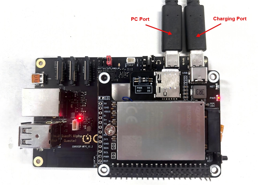

Use qusb to Test USB Port Emulating Network Interface Card Function
  • View all functions supported by usb:
    root@qcm6490-idp:/# qusb showpid
    A4A1: NCM
    4EE7: ADB
    900E: DIAG
    901C: DIAG,UAC2
    901D: DIAG,ADB
    9015: MASS_STORAGE,ADB
    9024: RNDIS,ADB
    902A: RNDIS,MASS_STORAGE
    902B: RNDIS,ADB,MASS_STORAGE
    902C: RNDIS,DIAG
    902D: RNDIS,DIAG,ADB
    902F: RNDIS,DIAG,MASS_STORAGE
    908C: NCM,ADB
    90CA: DIAG,UAC2,ADB
    90CB: DIAG,UVC,ADB
    90CC: DIAG,UAC2,UVC,ADB
    90DF: DIAG,UVC
    90E0: DIAG,UAC2,UVC
    9135: DIAG,QDSS,ADB
    9136: DIAG,QDSS
    F000: MASS_STORAGE
    F00E: RNDIS
  • Switch USB mode: qusb setpid 908C # Enable NCM+ADB. At this time, execute ifconfig -a in the device's shell to see the usb0 interface.
  • Connect the Type-C port of Quectel Pi H1 to the PC's USB port [PC system is recommended to be linux]
  • Set IP address for the usb0 interface of Quectel Pi H1: ip addr add dev usb0 192.168.0.5/24
  • Set address for the newly recognized USB network card on PC: ip addr add dev enp0s20f0u13 192.168.0.6/24 # Here enp0s20f0u13 needs to be modified according to actual situation
  • Test network: Execute ping 192.168.0.5 in the PC's SHELL #You can observe that the program can ping the destination address

Use the ifconfig command to view network interface addresses:
eth0      Link encap:Ethernet  HWaddr 32:C0:A2:09:FE:40
          Interrupt:167 Base address:0x1000
          RX packets:75 errors:0 dropped:0 overruns:0 frame:0
          TX packets:75 errors:0 dropped:0 overruns:0 carrier:0
          RX bytes:6301 (6.1 KiB)  TX bytes:6301 (6.1 KiB)
          inet addr:192.168.253.211  Bcast:192.168.253.255  Mask:255.255.255.0
          UP BROADCAST RUNNING MULTICAST  MTU:1500  Metric:1
          RX packets:3421 errors:0 dropped:0 overruns:0 frame:0
          TX packets:61 errors:0 dropped:0 overruns:0 carrier:0
          RX bytes:151273 (147.7 KiB)  TX bytes:7300 (7.1 KiB)
It can be seen that wlan0 port has obtained IP.
