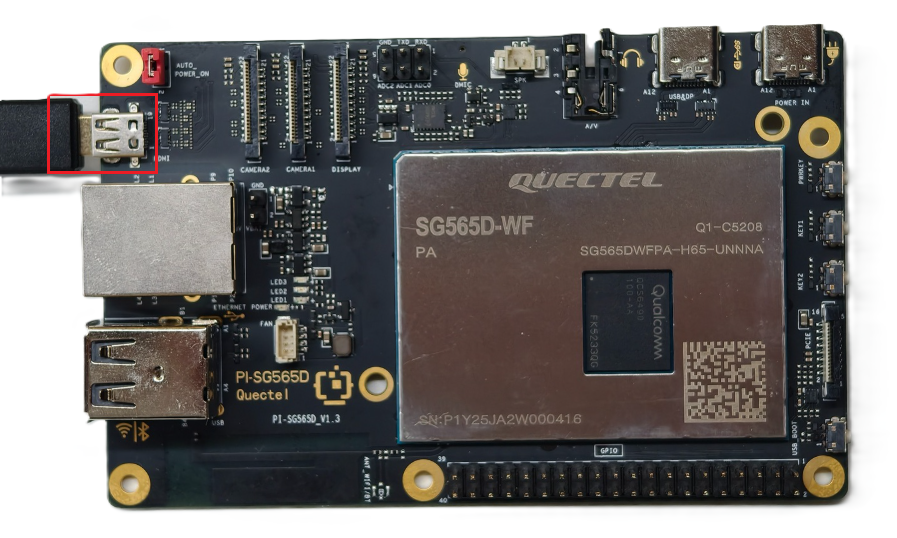

Display Connection
Connect one end of the Micro HDMI cable to the Micro HDMI port of the single-board computer and the other end to the HDMI port of the monitor.

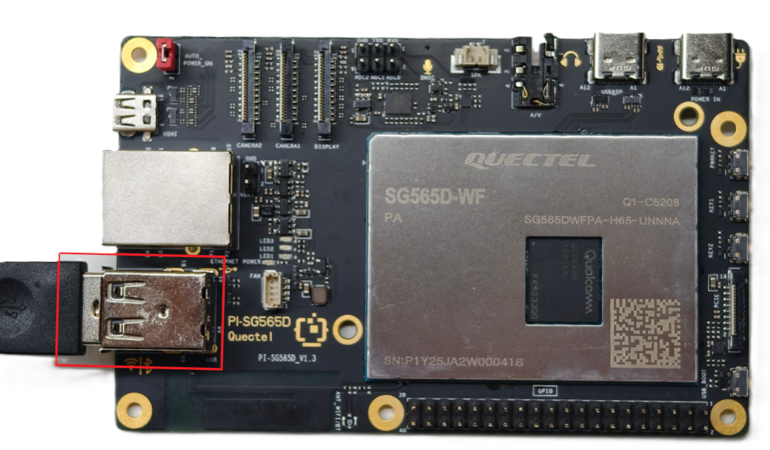

Input Device Connection
Connect the USB keyboard and mouse to the two USB-A ports on the single-board computer. If using a wireless input device, just plug the receiver into the USB port.

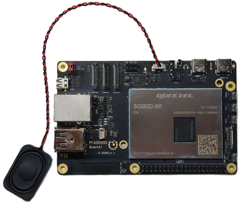

Speaker Connection
Connect the 2-pin PH1.25 speaker to the board’s speaker output.

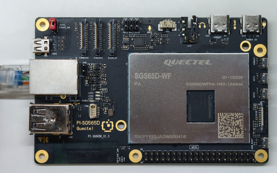

Network Connection
Connect one end of the Ethernet cable to the Gigabit Ethernet port of the single-board computer, and the other end to the Ethernet port of the router (ensure the router is already connected to the network).

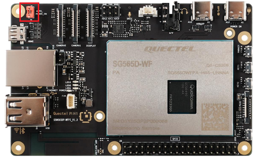

Jumper Cap Connection
Locate the pin header labeled AUTO_POWER_ON at the upper left corner of the single-board computer, and ensure it is shorted with a jumper cap.

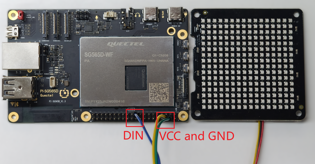

Connecting the 16×16 WS2812
The 16×16 WS2812 RGB LED matrix display is connected to the Quectel Pi H1 single-board computer via the SPI interface. Connect the WS2812 data input to the corresponding interface pin on the Quectel Pi H1.

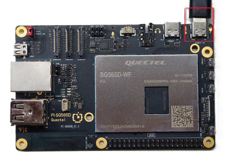

Power Connection
Connect the USB-A end of the USB-A power cable to the power supply, and connect the USB-C end to the power port of the single-board computer (usually labeled POWER IN).

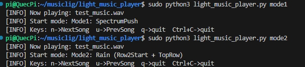

Running the Program
Run the following commands in the project directory to start the program:
cd light_music_player
sudo python3 light_music_player.py
The lighting effect can be configured as mode1 or mode2. After the program starts, it will automatically begin playing music and display lighting effects synchronized to the music rhythm on the 16×16 WS2812 LED matrix.
After the program is running, the terminal will show the key controls (n for next track, u for previous track, q or Ctrl+C to exit the program).
