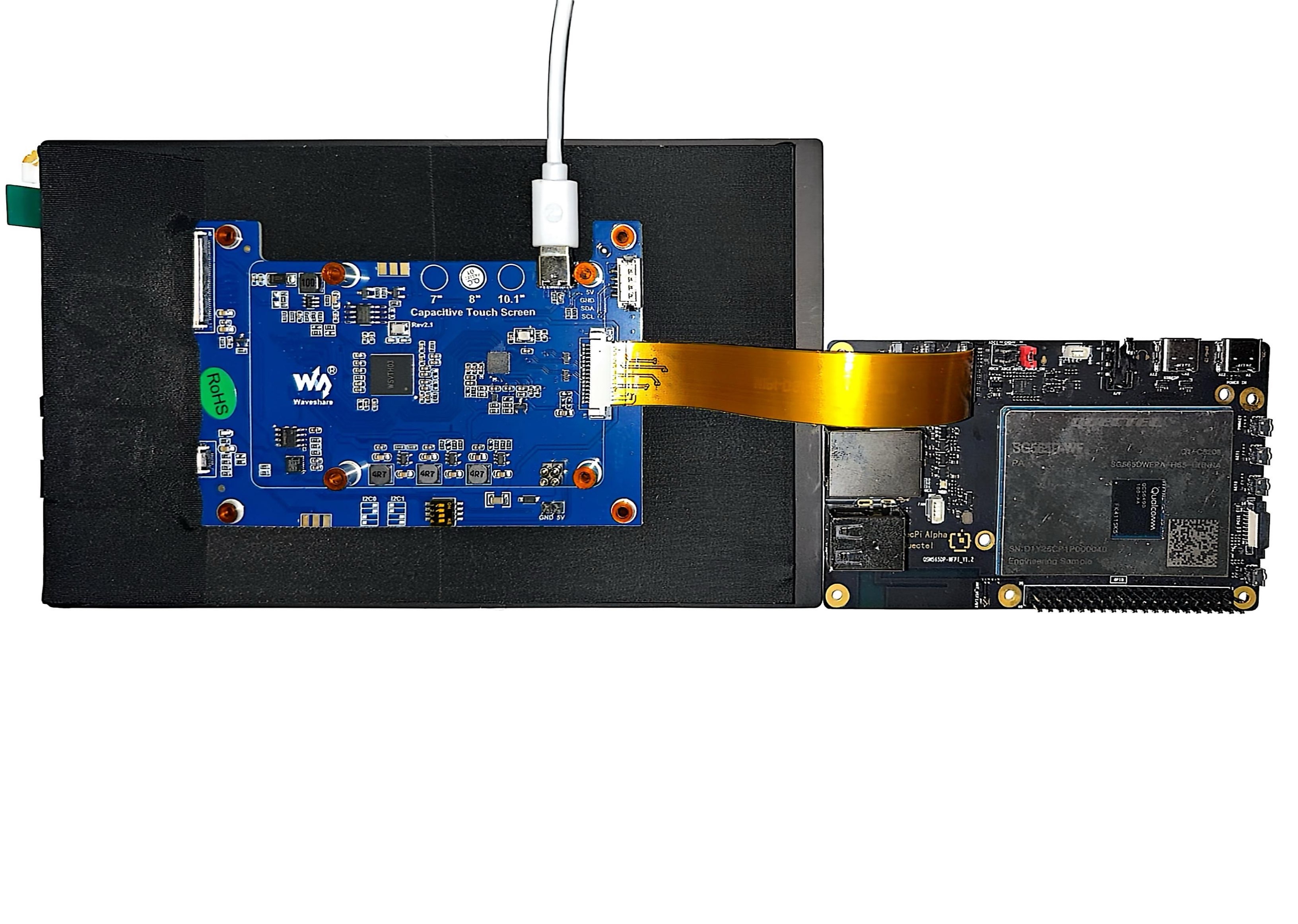

MIPI display connection
Follow the diagram below for connection:

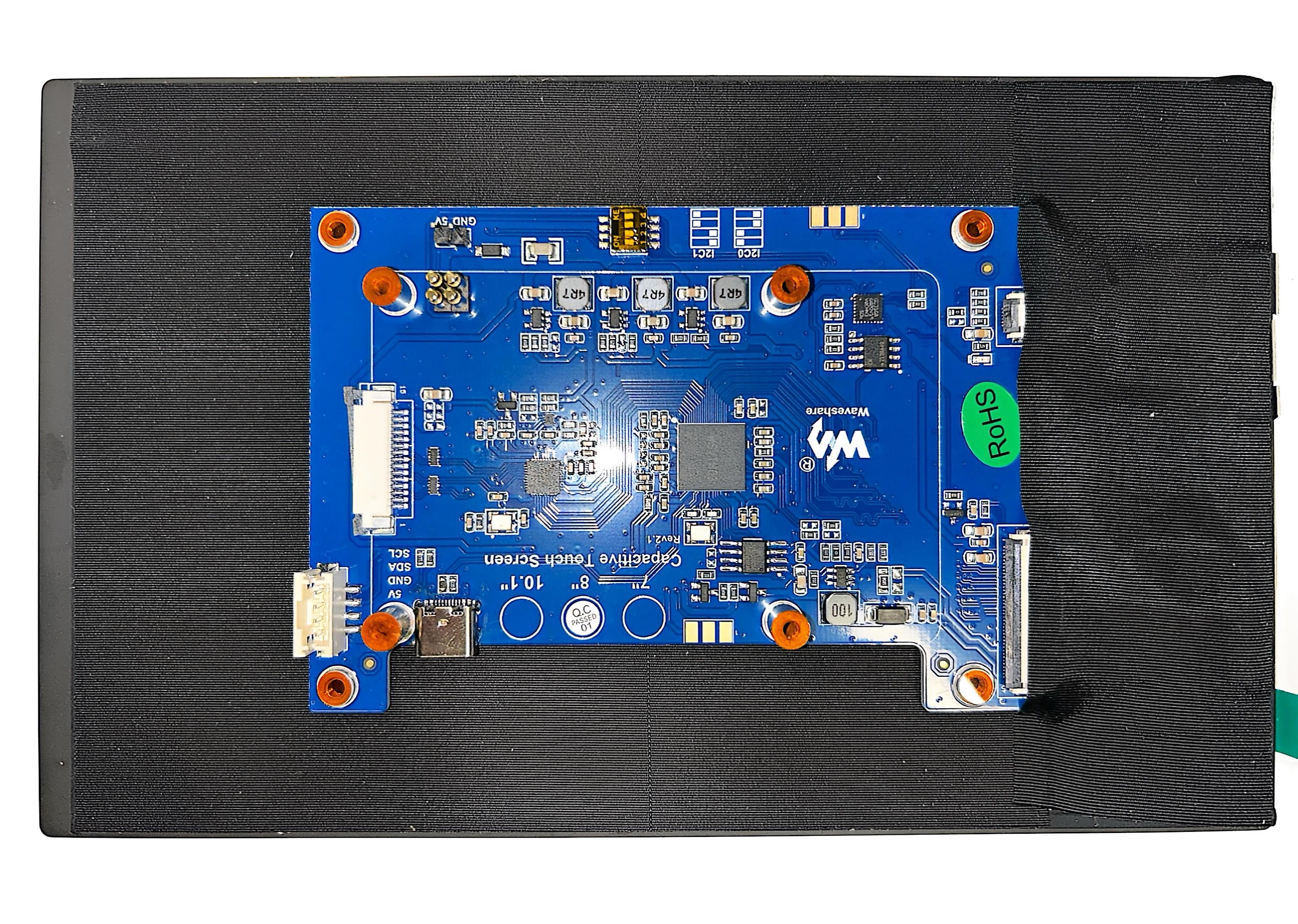

Note: This display has 4 power supply interfaces, so choose any one. In this example, power is supplied at position "1".
  1. Type-C interface.
  2. I2C communication and power supply interface.
  3. 5V input/output interface.
  4. I2C communication and power supply interface. Align the screw holes with the Quectel Pi H1 single-board computer and tighten the screws to ensure firm contact between the pogo pins and the 40-pin header.
Image 1
Back view of Waveshare 8-inch MIPI display
Image 3
Hardware connection setup

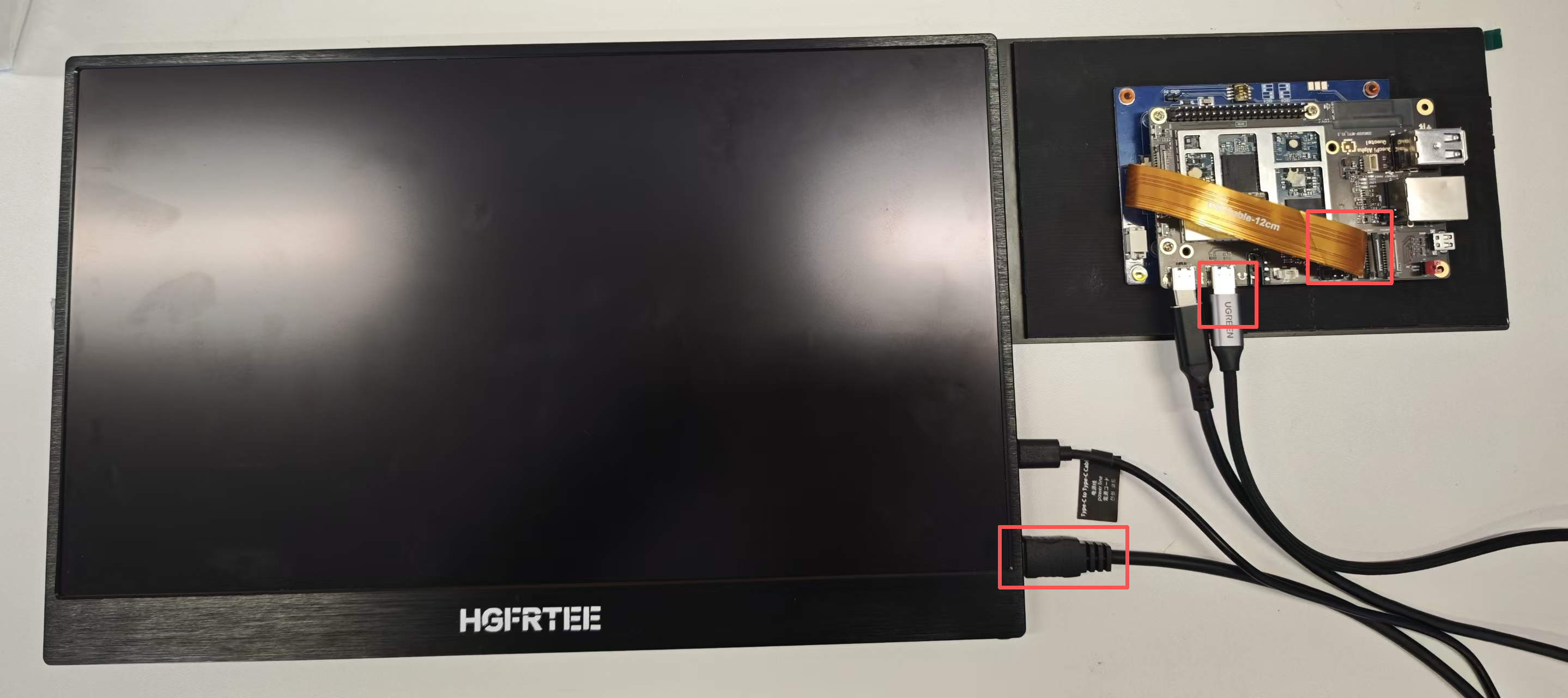

Dual display connection
Dual display function allows simultaneous display on both MIPI and HDMI displays on the single-board computer.
Note: To use this function, connect the MIPI display and connect an HDMI display via the DP interface using an adapter.
Dual display configuration
After connecting the hardware, the system will automatically detect both display devices. By default:
The MIPI display serves as the primary display showing the complete desktop environment, while the HDMI display serves as an extended display for extended viewing.

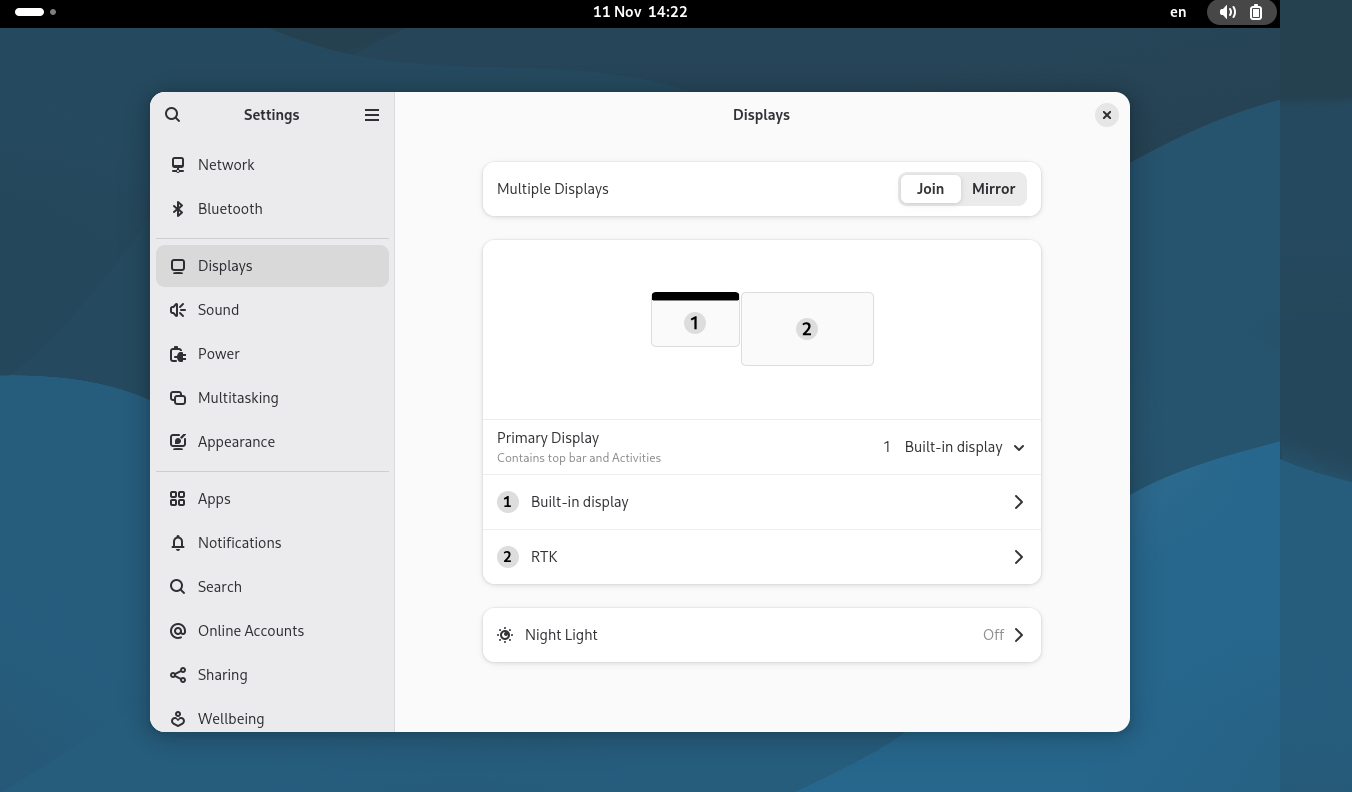

  1. Open Settings → Displays.
  2. In the display settings, you can see the identification for both displays.
The display identification is shown below:
3. Select the desired display mode:
  • Joined display: Two displays show different content and can be operated independently.
  • Mirrored display: Both displays show the same content.
