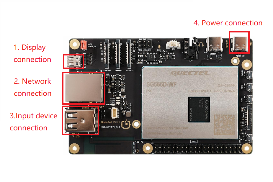

Hardware Connection
Complete the following hardware connections. The interface reference diagram is shown below:
  1. Display connection: Connect one end of the Micro HDMI cable to the Micro HDMI port of the main control board and the other end to the Micro HDMI port of the display.
  2. Network connection: Connect one end of the Gigabit Ethernet cable to the Gigabit Ethernet port of the main control board and the other end to a router port.
    Alternative: connect to the same LAN over Wi-Fi.
  3. Input device connection: Connect a USB keyboard and mouse to the two USB-A ports on the main control board. For wireless input devices, plug the receiver into a USB port.
  4. Power connection: Connect the USB-A end of the power cable to the power adapter and the USB-C end to the power port labeled POWER IN on the main control board.

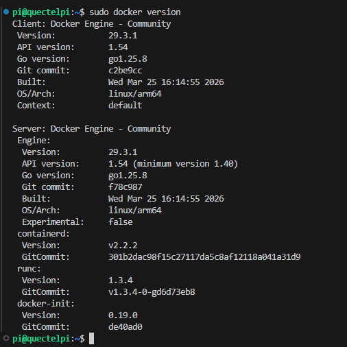

4.Enable Docker at boot and verify the installation:
sudo systemctl enable docker
sudo systemctl start docker
sudo docker version

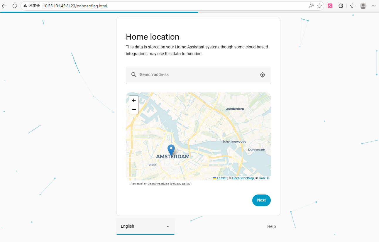

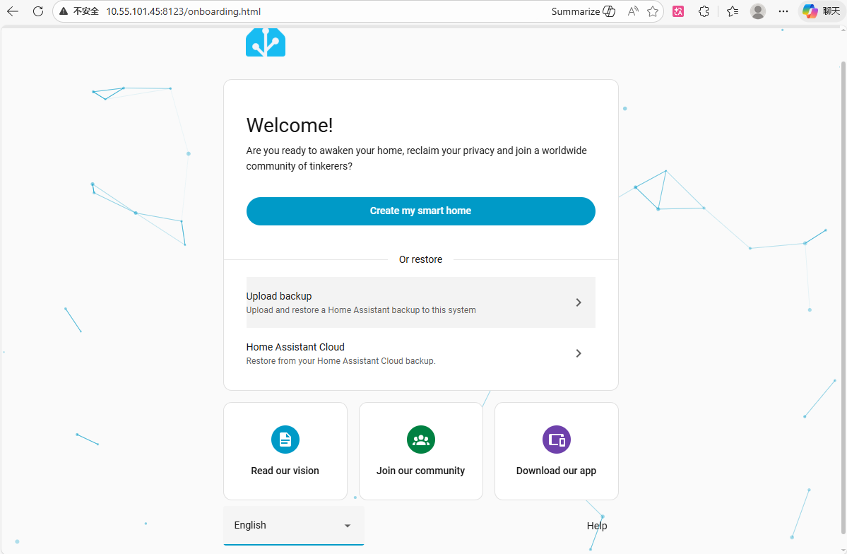

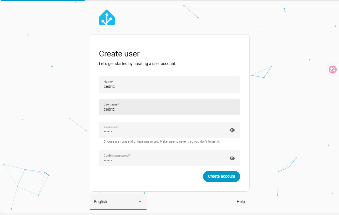

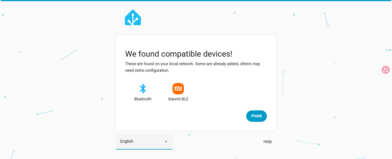

Access the Home Assistant Console
Open a browser within the LAN and visit the following address (replace <QuectelPi-IP> with the actual IP address of the main control board):
http://<QuectelPi-IP>:8123

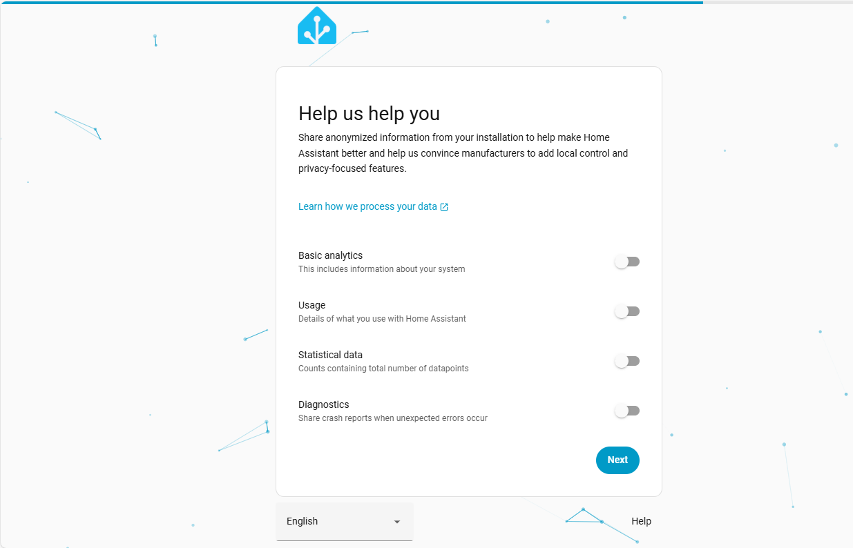

After entering the console, complete user creation and the initial setup to start using the system. The reference interface is shown below:

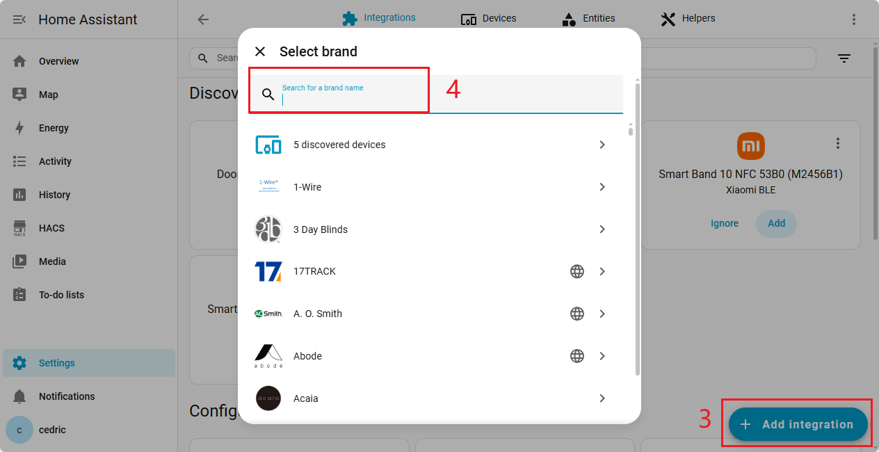

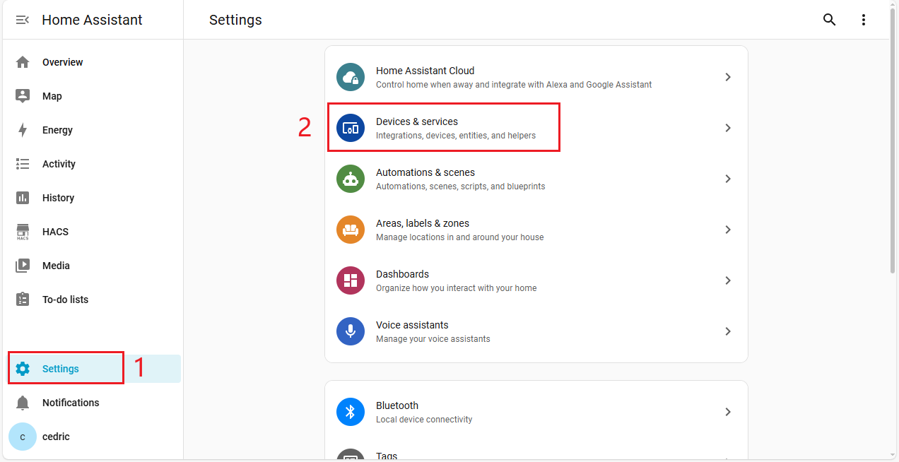

Integrate Smart Devices
Wi-Fi lights, cameras, and other smart devices can be integrated into Home Assistant for unified management. Follow these steps:
1.Open the Home Assistant console and click Settings.
2.Select Devices & Services, then click Add Integration.
3.Search for the device brand name and follow the on-screen instructions to add the corresponding integration.

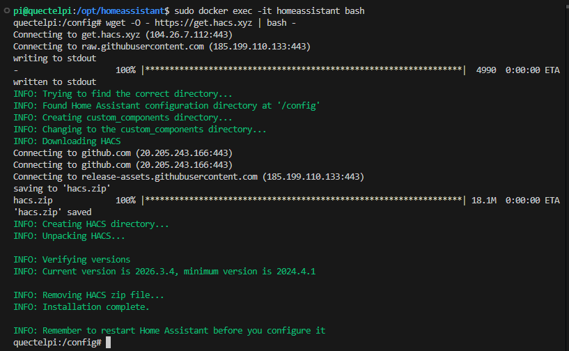

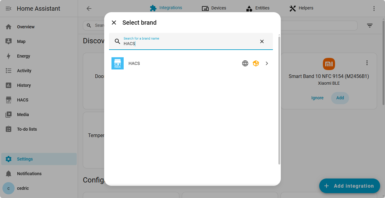

Install HACS (Home Assistant Community Store) as an Extension
Note: HACS is a community open-source plugin library. Please comply with its open-source license and related terms before use.
HACS can expand the Home Assistant plugin ecosystem. Install it as follows:
# Check the container running status
sudo docker ps --format "table {{.Names}}\t{{.Image}}\t{{.Status}}"
# Enter the Home Assistant container
sudo docker exec -it homeassistant bash
# Run the official HACS installation script
wget -O - https://get.hacs.xyz | bash -
# Exit the container and restart Home Assistant
exit
sudo docker restart homeassistant

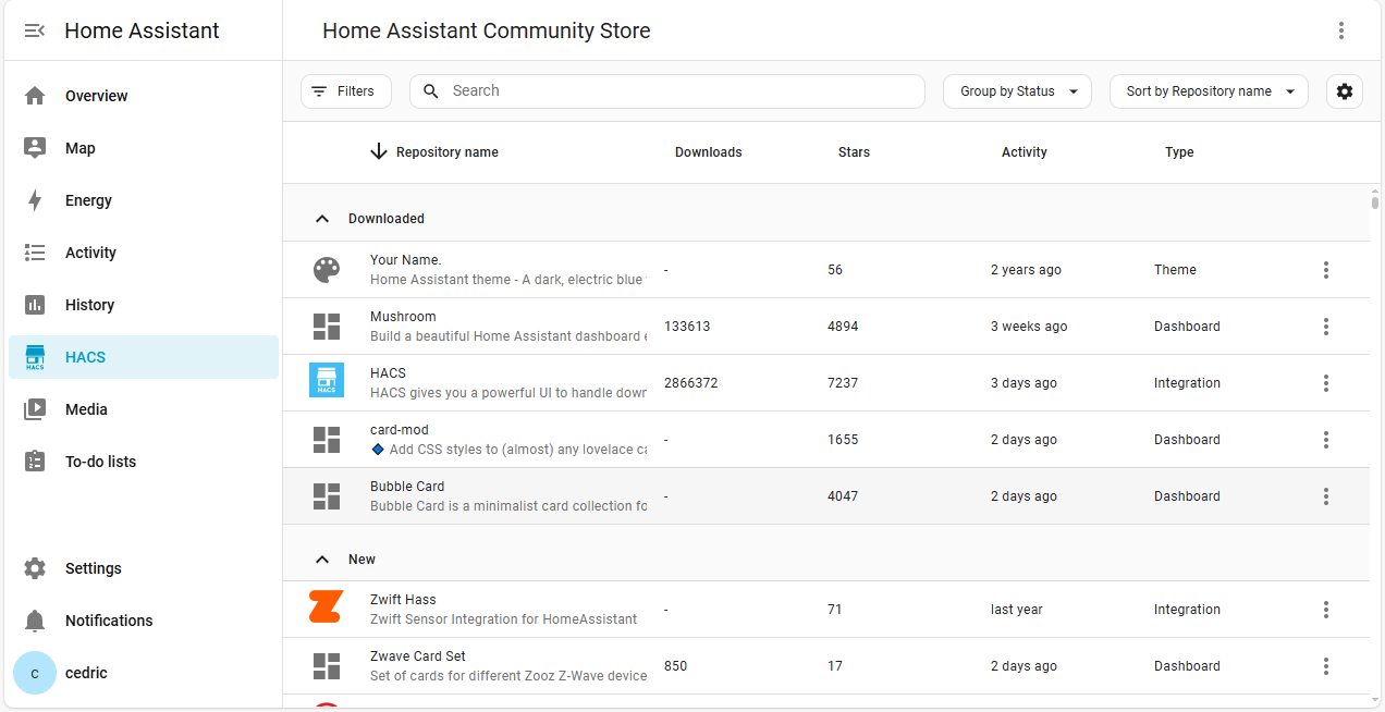

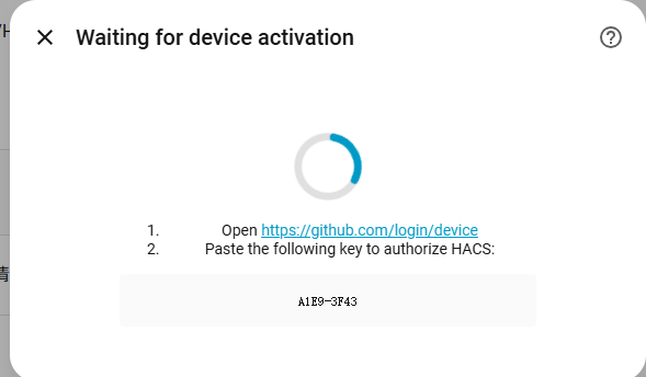

After installation, restart Home Assistant, then search for HACS in Settings → Add Integration and complete the setup:
Using HACS requires signing in with a GitHub account for authorization. After authorization, community plugins can be downloaded:

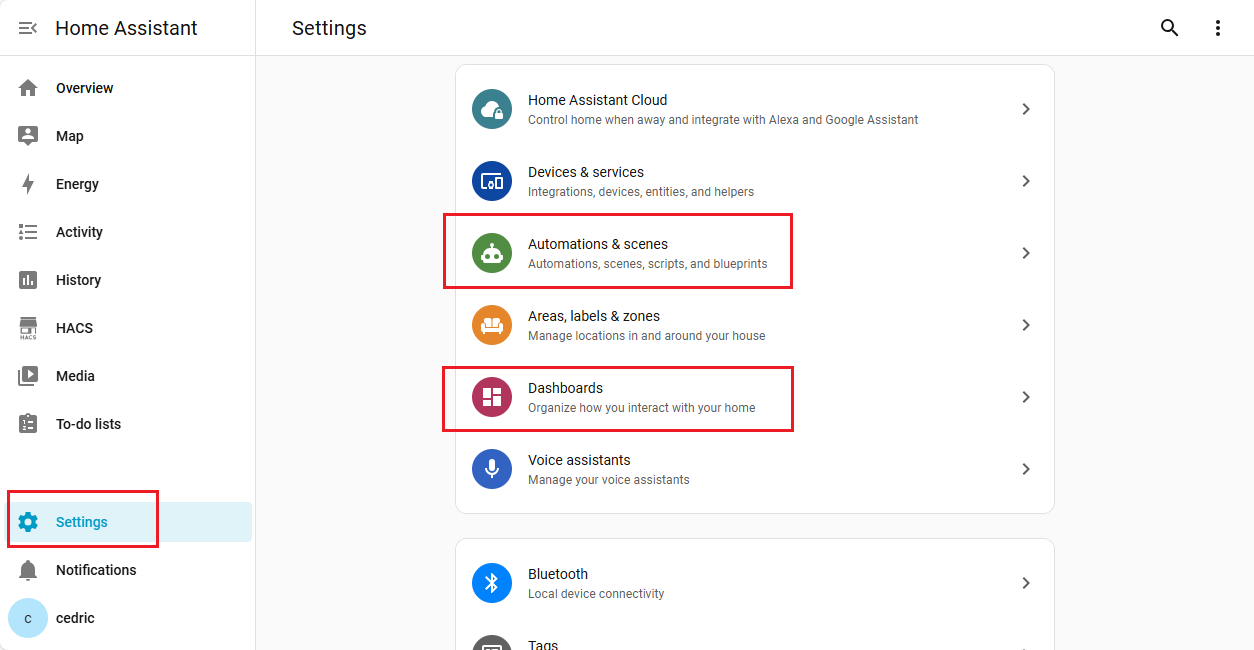

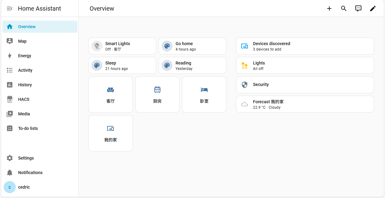

Create Scenes and Dashboards
  • Scene: Save the status of smart devices to enable one-click linkage control of multiple devices.
  • Dashboard: Centrally overview all devices and their associated area information.
For detailed configuration, refer to theofficial Home Assistant documentation

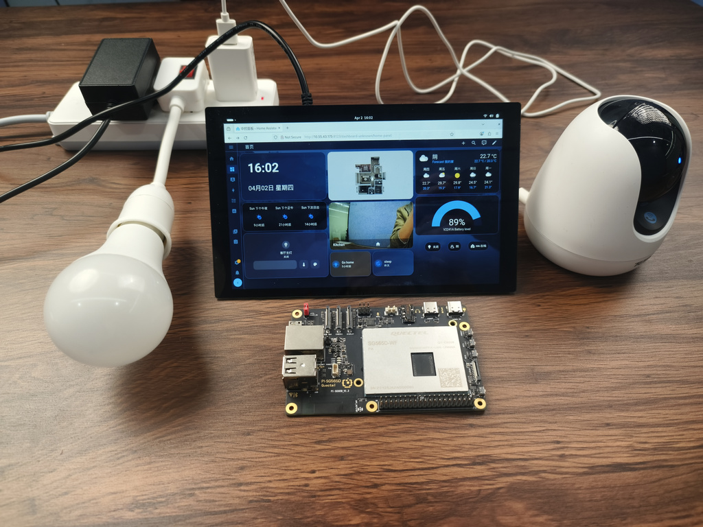

Application Demo
