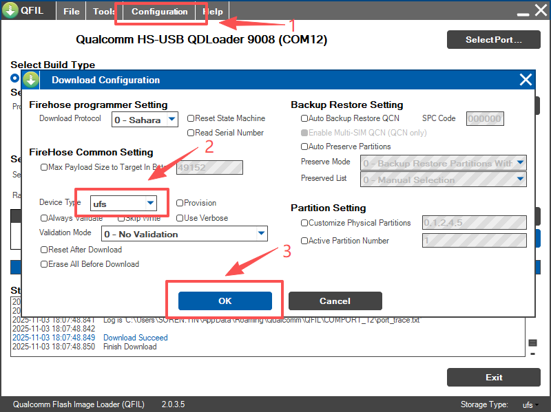

Configure QFIL
Click the menu bar Tools → Configuration, and make the following settings in the configuration window:
  1. In Device Type, select ufs.
  2. In Validation Mode, select 0 - No Validation.
  3. Click OK to save the configuration.

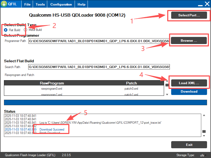

Flashing steps
1. Select port
  • Long press the EMG_DOWNLOAD button on Quectel Pi H1 and power Quectel Pi H1 on at the same time.
  • Click the SelectPort button, select the 9008 port, and click OK.
2. Select build type
  • In Select Build Type, select Flat Build.
3. Select programmer file
  • Click the Browse button.
  • Select the prog_firehose_Qcm6490_ddr.elf file.
4. Load XML configuration files
  • Click the Load XML button.
  • Select all rawprogram*.xml and patch*.xml files.
5. Start flashing
  • Click the Download button to start flashing.
  • When the Status area displays Download Succeed, it indicates successful flashing.
  • The system will automatically restart.
