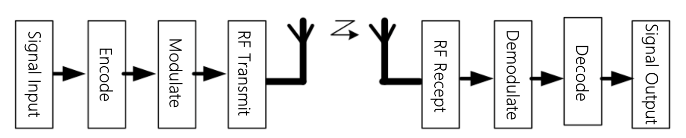

Modern communication systems also encompass similar elements but in a more complex and efficient manner. Users who have used dial-up access may be familiar with the term "modem". Telephone lines and networks are designed to transmit analog audio signals ranging from 300 Hz to 3400 Hz and are not suitable for direct transmission of network data. To enable bidirectional communication between computers over telephone lines, two basic requirements must be met:
  • Through the operating system and network interface, convert user raw data into standardized data formats that can be recognized and transmitted between network devices. This process, which involves standardizing data formats to improve information transmission efficiency and system effectiveness, is typically referred to as "coding". The corresponding process at the receiving end is known as "decoding".
  • Through the modem, convert digital signals into analog signals suitable for transmission over telephone lines, and vice versa. This process, which involves various transformations of the original signal to enable publication through different communication media or carriers, is typically referred to as "modulation". The corresponding process at the receiving end is known as "demodulation". The purpose of modulation and demodulation is to adapt to the channel characteristics, overcome channel interference, and enhance signal transmission quality.
In addition to telephone lines, there are many other communication media available, such as radio waves, optical fibers, and satellites. Different communication media possess distinct characteristics and advantages, requiring the use of different encoding and modulation techniques. For example, a radio wave can be propagated through the air without physical connections but is easily interfered with by other radio waves. To allocate and utilize frequency spectrum resources, techniques such as frequency multiplexing, code multiplexing, and orthogonal multiplexing are employed. Optical fibers can transmit high-speed and high-capacity optical signals with low loss, high bandwidth, and resistance to interference, but require special optoelectronic conversion devices to achieve optical-to-electrical signal conversion by using pulse code modulation, phase modulation, and frequency-shift keying. Satellites can provide coverage over extensive areas for long-distance communication but require high-power transmitters and receivers. Techniques such as multiple access, frequency-hopping spread spectrum, and quadrature phase shift keying are employed to facilitate communication between satellites and ground stations.
Communication technology is an interdisciplinary science involving various disciplines, including information theory, signal processing, circuit theory, microwave technology, antenna technology, and network technology. However, as users or ordinary developers, you do not need to delve into excessive details. Various terminal devices and communication modules handle most aspects for us. Our focus should be on selecting and utilizing specific communication methods.
Diagram of a wireless communication system

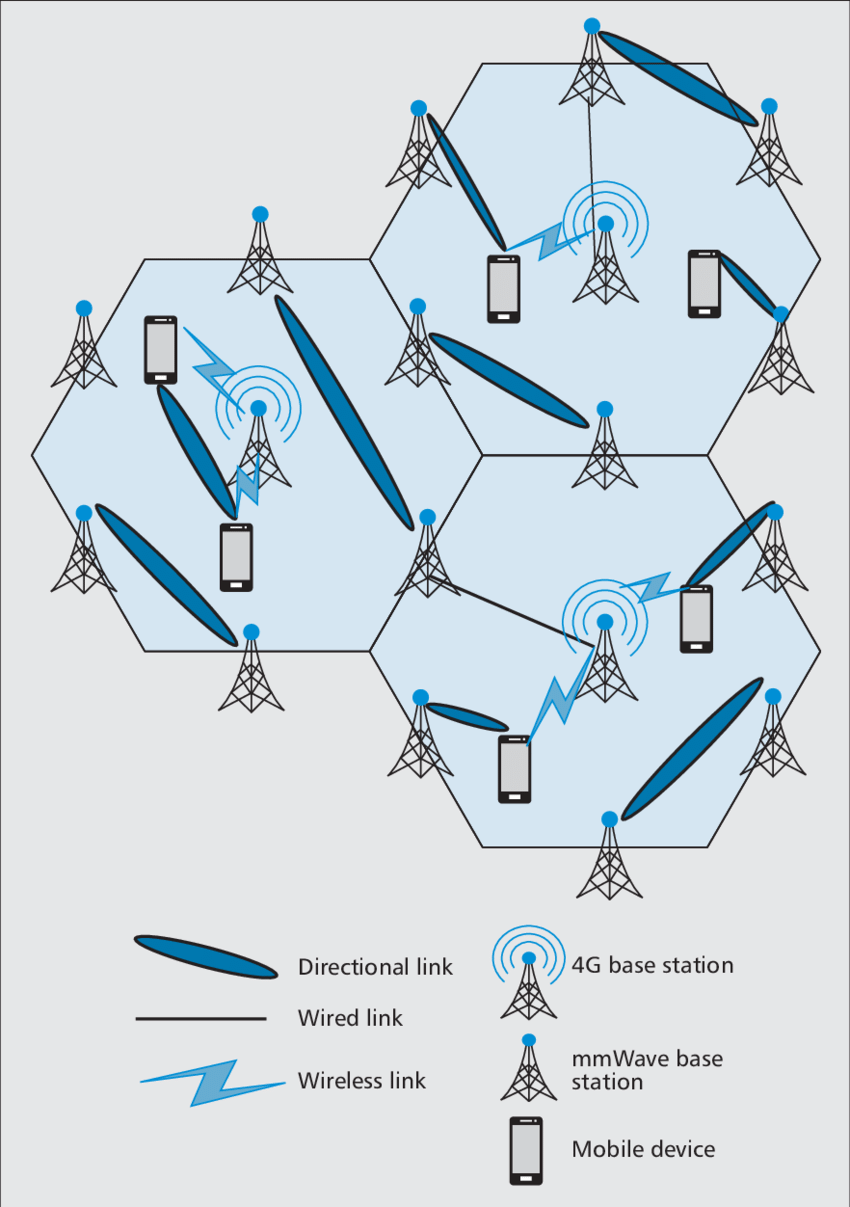

A cellular network, also known as a mobile network, is a wireless communication technology that enables mobile devices, such as smartphones and tablets, to transmit voice, data, multimedia, and other services in different geographical areas. The cellular network is the foundational infrastructure of modern mobile telephone and personal communication systems, playing a crucial role in driving the process of society digitization.
Diagram of 5G Millimeter Wave Cellular Network Structure
As shown in the diagram above, the core idea of a cellular network is to divide a large service area into multiple smaller cells. Each cell is equipped with a base station responsible for wireless communication with mobile devices within that cell. These base stations are interconnected through wired or wireless connections, forming a network that covers the entire service area. In traditional theory, these cells are designed as hexagonal, circular, or square shapes, with hexagons being the most common. The interconnection between cells enables complete coverage of the region, resembling a honeycomb, which is why this technology is referred to as cellular networks. Nowadays, the coverage areas of many base stations no longer have a cellular shape, but the term has persisted.

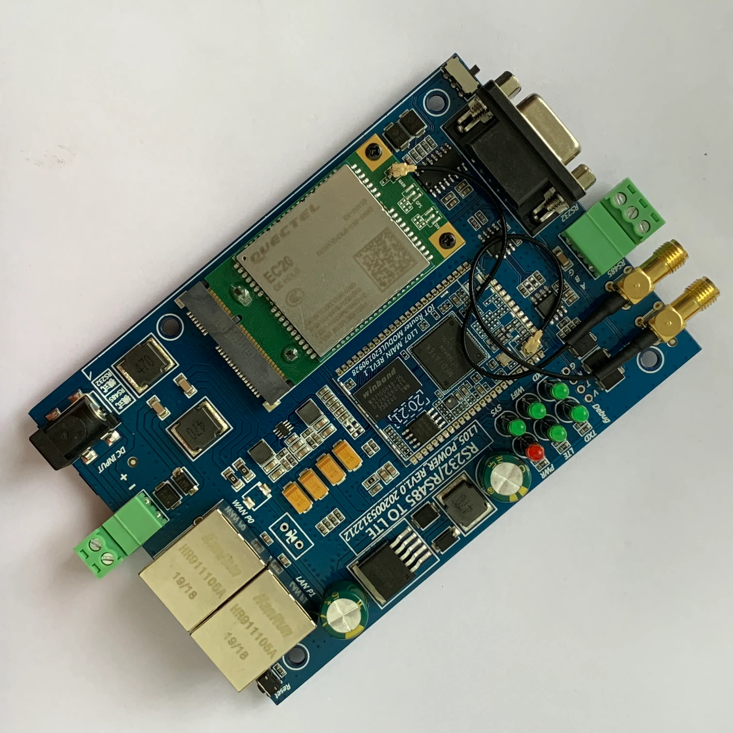

A wireless communication module, also known as a module or module unit, is an essential component for achieving data connection to IoT platforms and remote communication. It has been widely used in various IoT scenarios. From the perspective of functionality, a module serves as a bridge between local devices and networks. Just like plugging a USB network card into a computer to start accessing the internet, adding a module to an embedded system enables the connection to a wireless network.
Mainboard of an IoT Device Integrated with a Quectel EC20 Module
Many users who encounter modules for the first time may feel unfamiliar with this strange device covered by a metal shield. Modules are different from traditional chips and discrete components. In reality, the essence of a module is a small Printed Circuit Board Assembly (PBCA). When we remove the metal shield on the surface of the module, we can still see a familiar (but denser) PCB circuit structure inside.

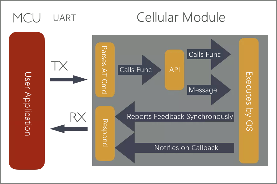

About AT Commands
AT command is one of the oldest and most widely-used communication command sets in the industry. It establishes a complete bidirectional communication mechanism between users (or MCUs) and modules. Users (or MCUs) control the module by sending AT commands, which include various functions such as network connection, voice call, and positioning. The module then returns the execution results and status to the user. This "send and receive" mechanism and the simple processing method are well-suited for embedded environments with limited resources. Nowadays, most modules on the market come with built-in AT server programs that can receive, parse, and execute specific AT commands.
Operation Mode of AT Commands
For developers using modules in Standard Mode, the main development effort lies in the user app running on the MCU. The business codes in the app need to include complex functionalities such as sending AT commands and parsing return values, including handling Unsolicited Result Codes (URC), which is challenging for beginners.
In addition to the AT command functionality, modules in Standard Mode can also serve as wireless network cards, providing a range of network services, including PPP dial-up networking, to the MCU or other host devices.
