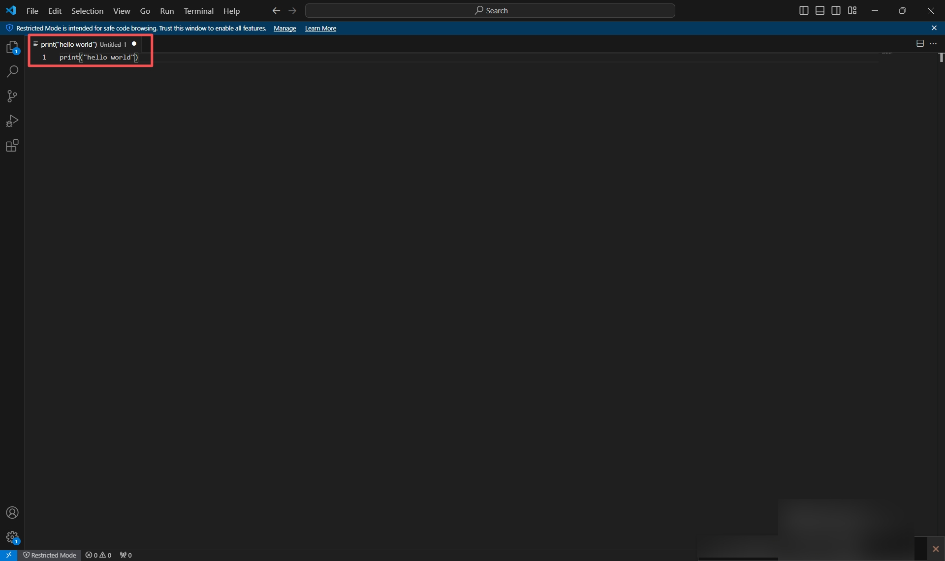

Open VSCode and enter the following string:
print("hello world")

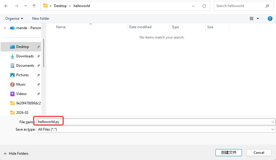

Next, save the written script locally and name the file helloworld.py (only English letters, numbers, and underscores are allowed; Chinese characters and special characters are prohibited).

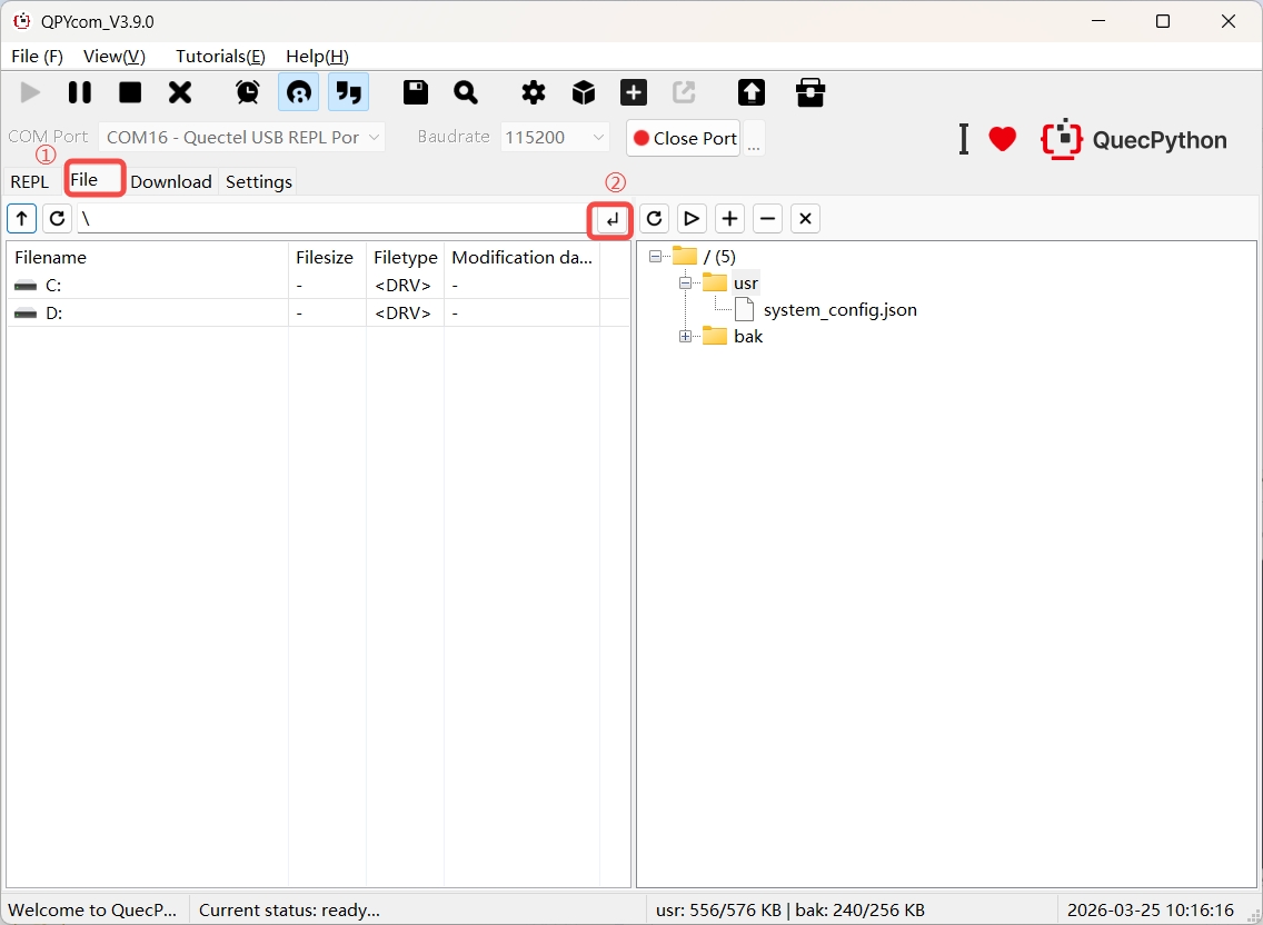

Method 1: Transfer via Drag-and-Drop
Open QPYcom, click File, then click the button shown in the figure to select the path of the helloworld.py script file.

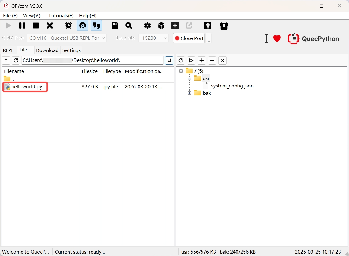

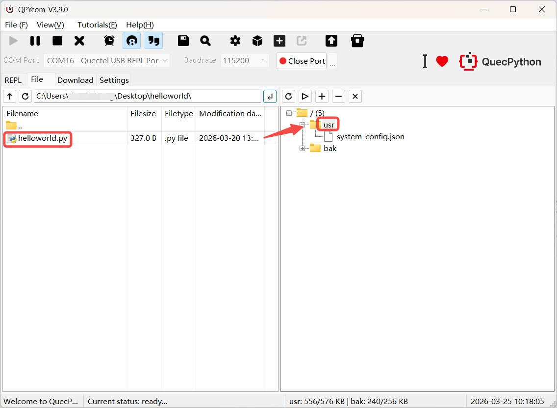

After selecting the path where the helloworld.py script file is stored, the written script file can be seen on the left side.
image-2021081301
Drag the helloworld.py script file from the left side to the usr directory on the right side for transfer. The download progress and result will be displayed in the status bar at the bottom.
image-2021081301

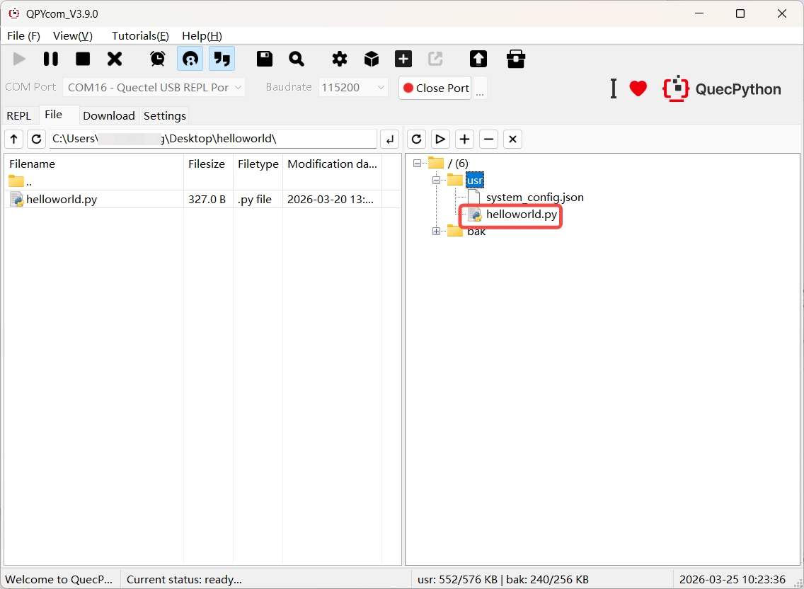

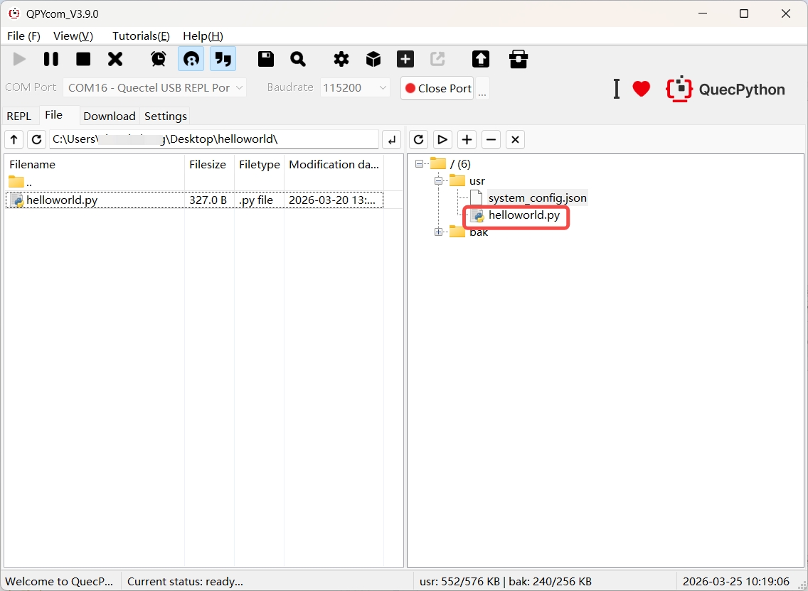

The display of helloworld.py in the usr directory on the right side indicates that it has been successfully transferred to the module.
image-2021081301

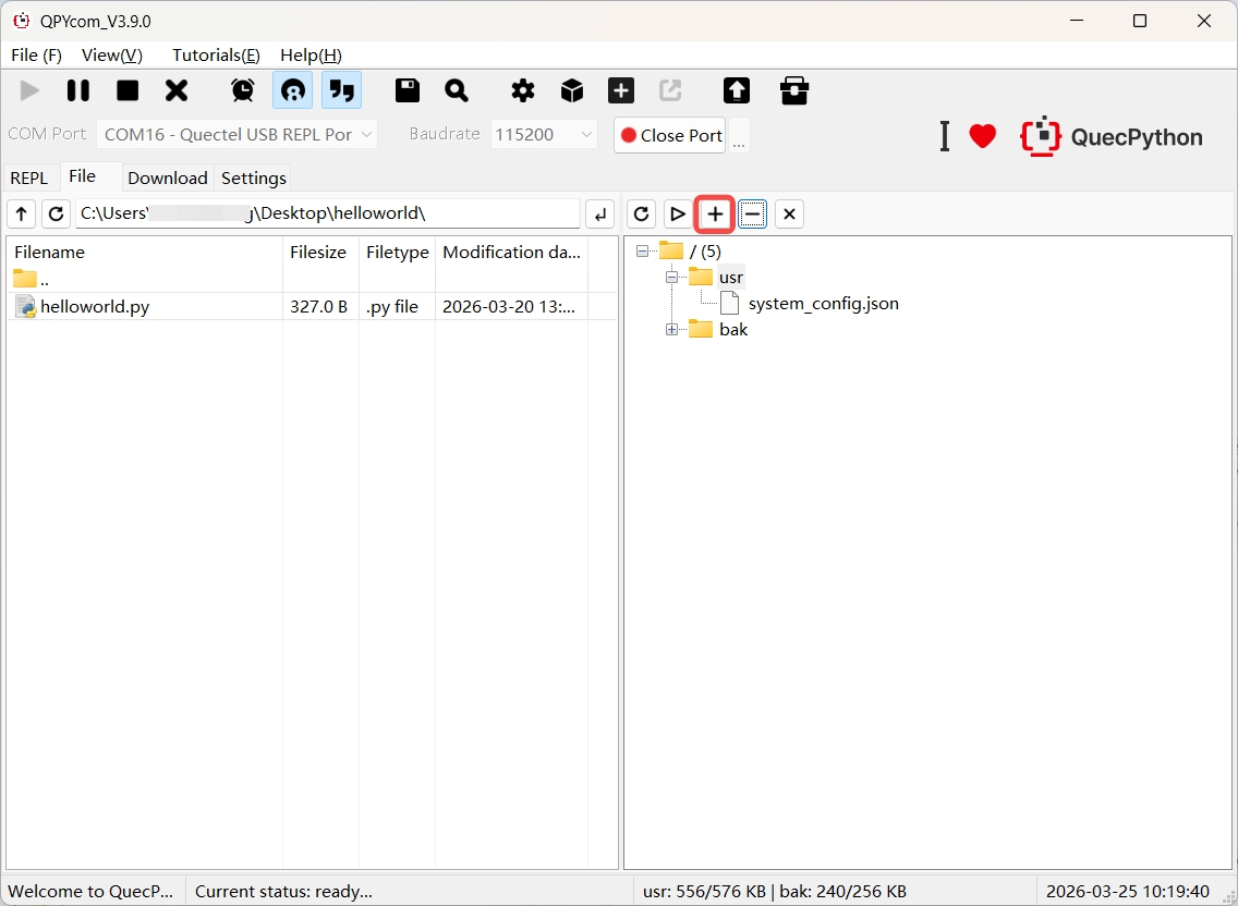

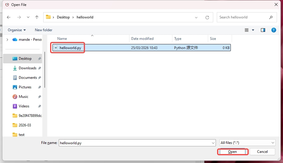

Method 2: Transfer via Tool Buttons
Click the "+" button on the right side to transfer the file.
image-2021081301
Locate the written helloworld.py file and click Open in the bottom right corner.
image-2021081301
image-2021081301

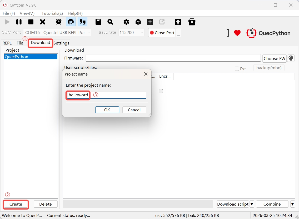

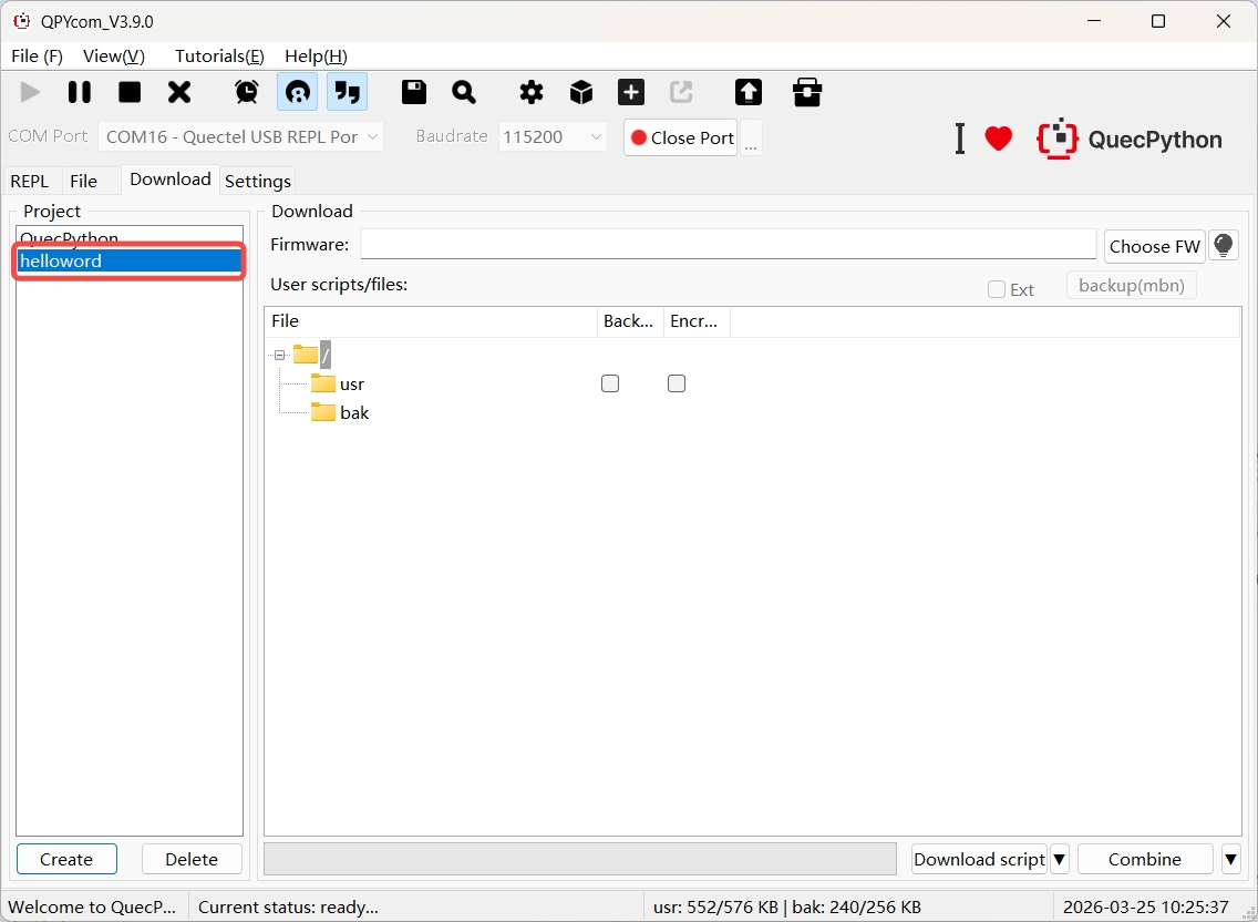

Method 3: Transfer by Creating a User Project
Click the Download page.
Create a user project (click the "Create" button).
Enter the project name and click "OK".
image-2021081301
The created project is displayed on the left side.
image-2021081301

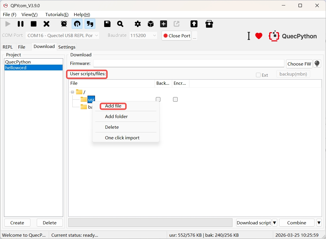

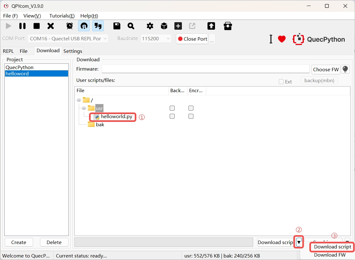

In the "User Scripts/Files" area, select the root directory of usr, right-click and select Add File.
image-2021081301
After successful addition, the helloworld.py file ready for transfer will be displayed. Click the icon in the bottom right corner , and options "Download Script" and "Download Firmware" will appear. Select Download Script for transfer.
image-2021081301

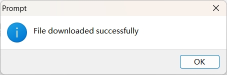

After successful download, a prompt "File downloaded successfully" will appear.
image-2021081301

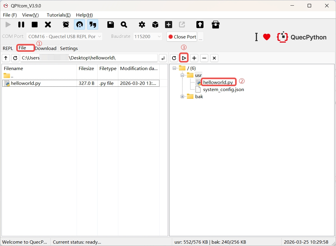

Method 2: Execute the Script via GUI Tool
On the file page of the tool, select the helloworld.py script file to be executed, then click the button to run it.
image-2021081301

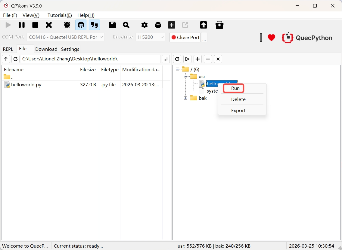

Method 3: Run the Script File via Right-Click Menu
Select the script file and right-click to run it.
image-2021081301
