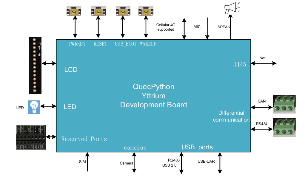

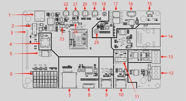

The main components and interface layout of the evaluation board are shown below:

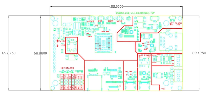

Evaluation board dimensions (top view):

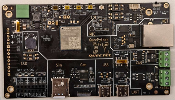

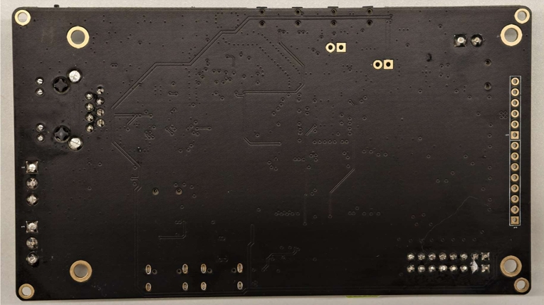

Top view and bottom view of the evaluation board:

Board Interfaces
The detailed assignment of the board interfaces is as follows:
No. Interface Description
Reserved Ports
6 (J0702) 1 × 8-Pin Header MAIN_TXD, MAIN_RXD, LCD, CTP_INT, GND, ADC signals
6 (J0703) 1 × 8-Pin Header QSPI_D3, QSPI_D2, LCD signals
Buttons & Switches
2 S0301 Determines the board power source: toggle up for external DC 5V; toggle down for USB Type-C 5V
5 S0705 DIP switch for LED_PWM4 / GPIO2 multiplexing. S0705 pins 2-4 ON + S0502 pins 1-3 OFF: LED_PWM4 controls IND_LED. S0705 pins 2-4 OFF + S0502 pins 1-3 ON: LED_PWM4 provides PWM4 audio output. S0705 pins 1-3 ON: GPIO2 controls buzzer BEEP
11 S0401 Determines main UART routing: toggle left for USB Type-C UART; toggle right for RS485
15 S0601 DIP switch for SPI0 routing to NET or FLASH
17 S0501 / S0502 S0501 ON + S0502 OFF: module PCM pins route through Codec to amplifier and speaker. S0501 OFF + S0502 ON: module PWM4 pin routes through filter circuit to amplifier and speaker
19 WAKEUP Press to wake up the module
20 USB_BOOT Press before power-on to enter forced download mode
21 RESET Press to restart the module
22 PWRKEY Press to power on the module
Communication
12 RS485 RS485 connector: RS485_A, RS485_B, GND; half-duplex
13 CAN CAN connector: CAN_H, CAN_L, GND; 1 Mbps data rate
14 Ethernet 1 × RJ45 connector, supports 10/100 Mbps Ethernet; Link LED and Activity LED indicators
Camera
8 (J0501) 1 × 18-Pin FPC Camera signal connector, supports 0.3 MP, SPI interface
Buzzer
4 BEEP Buzzer; S0705 pins 1-3 ON: GPIO2 controls buzzer BEEP
LCD Display
3 1 × 14-Pin Header LCD resolution 320×480; 4.0-inch screen; capacitive touch panel; display interface: 4-Line SPI, driver ICST7796S; touch interface: I2C, driver FT6336U
Audio
16 SPEAK Audio output, external speaker support
25 MIC Onboard microphone SOM4013SL-G423L
USB Ports
9 USB Type-C 1 × USB 2.0 Type-C, up to 480 Mbps data rate; can serve as power input
10 USB Type-C to UART 1 × USB 2.0 Type-C, up to 12 Mbps data rate; converted to TTL via XR21B1411IL16 chip, connected to module main UART
LTE Module
7 SIM Card Slot MUP-C7081-2, Nano SIM, 1.8V / 3.0V
18 Antenna Connector Supports external LTE antenna
Power & Startup
1 External DC Input 3.81mm terminal block, 5V ± 5%
23 (J0203) VBAT & VBAT12 Test Point Remove resistor R0204 above this test point; connect an ammeter in series to measure module current
24 PWRKEY & GND Test Point Short before power-on for auto-startup
